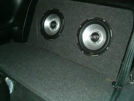

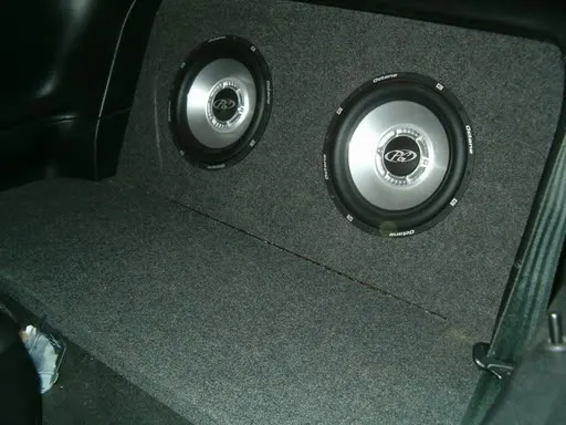

I planted two 12's in WITH my mach 460 and man it's some gooooood sound quality now

You should face them towards the trunk, it will be louder. I used to have 3 10's in mine and it was waaaay overkill. I split them up and only have 1 10" in it right now. With a nice class d amp and a ported box it sounds very decent. Its pretty light and doesnt take up much space at all.
