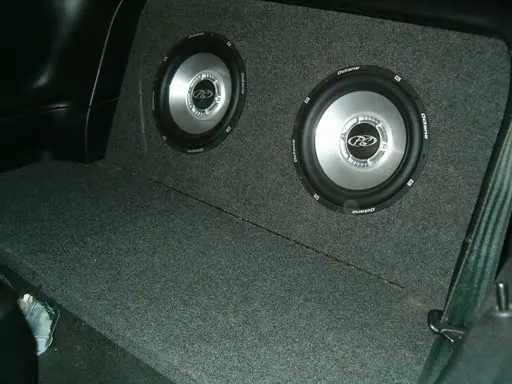

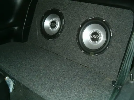

I've had a couple of aftermarket head units in my car with my mach 460 system and have never had even the slightest of a problem...:shrug:
I planted two 12's in WITH my mach 460 and man it's some gooooood sound quality now
That is TEH dope setup! :nice:
