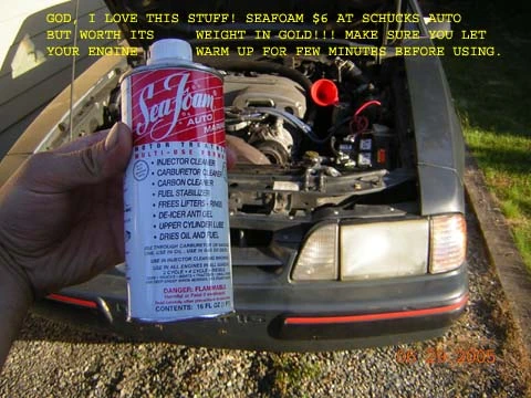

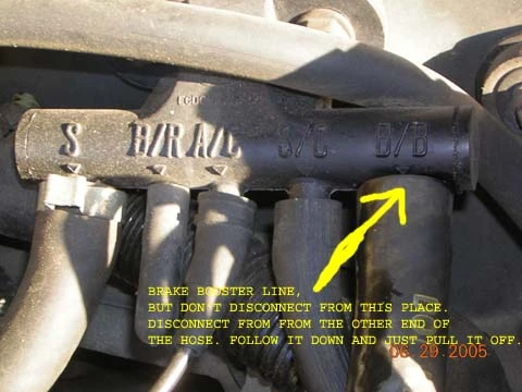

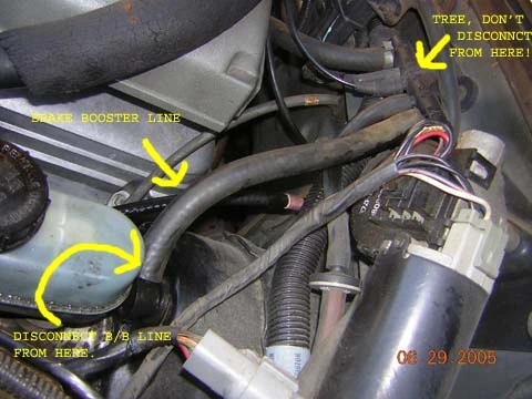

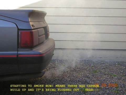

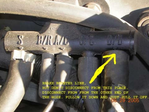

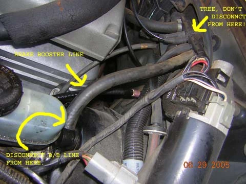

Thanks to wazazzle for sending me these pics.
Decided to host them for all who haven't seen them yet.
Pictures are worth a thousand words.

S&B said:
GREAT WRITEUP finally get to see some pix
dont people usualy put some in the crank case?
Or in the gas tank?

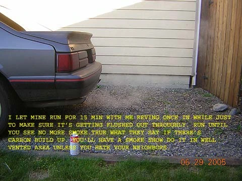

i used 3 cans of the stuff last year before i moved to FL i mixed 1 can with 3/4ths of a tank of gas 1 can in the vacume and 1/2 a can along with lucas mixed into the crankcase.. I made it from northern PA all the way to southern virginia on 3/4ths of a tank. Got like 36-40mpg on my trip and only filled up 2 times after the origional 3/4ths was up. Seafoam = teh win
I used it last week 1/2 can in the BB line. It works despite what anyone says and when people say it broke this and that it was probaly gonna break anyway. That smoke show in the pics is weak. Mine was crazy and it was also crazy on my 01 Cobra. I keep my rpms at around 2000 for a good 5 mins and then take it out and romp on it, make sure everything gets cleaned out. If you have not used it give it a shot, best $5 you can spend.
Does anyone have any slick methods of getting that hose off? Mine probably has never been removed and is on there damn tight. Maybe something under the hose to loosen it and pry it?
a really really good suggestion for this stuff also it to leave it in there for more than 15 minutes. a good idea is to leave it in there for a couple of hours to overnight then start it up. you will get a insane smoke show and the car will work a million times better if it hasnt been done before
i've done it to the stang, and the t/a, but since i was working at grease monkey the time i did it, i didn't really get any smoke because everytime i'd change my oil, i'd do a 3-part fuel system cleaner.... still worth it though, i put half in the b/b and dumped the rest in the gas tank.
So if I've got 45K on the motor, would you guys recommend using it? I've known about it for a while, but a couple people said it will mess my engine up blah blah blah, I don't really believe it, but yeah.
sunil6784 said:
What happens if you disconnected it from the tree and you poured it in that end ?
Then you would be pouring it into the brake booster?? :nono:
Or do you mean attempting to pour it up into the tree? This would work but you risk the chance of busting the tree (which can be VERY fragile) and you would need a section of hose... Just easier the way the write up went.
