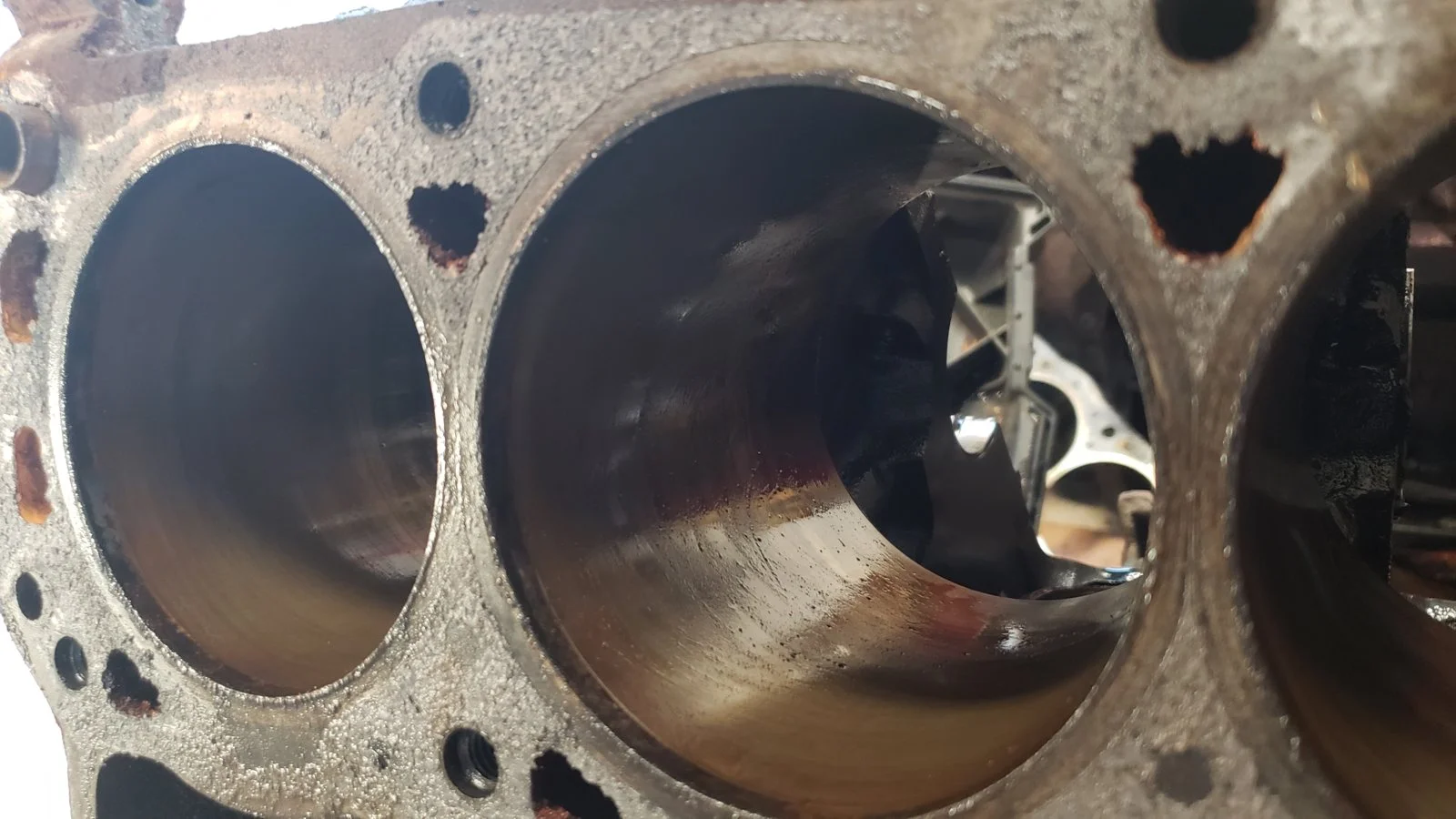

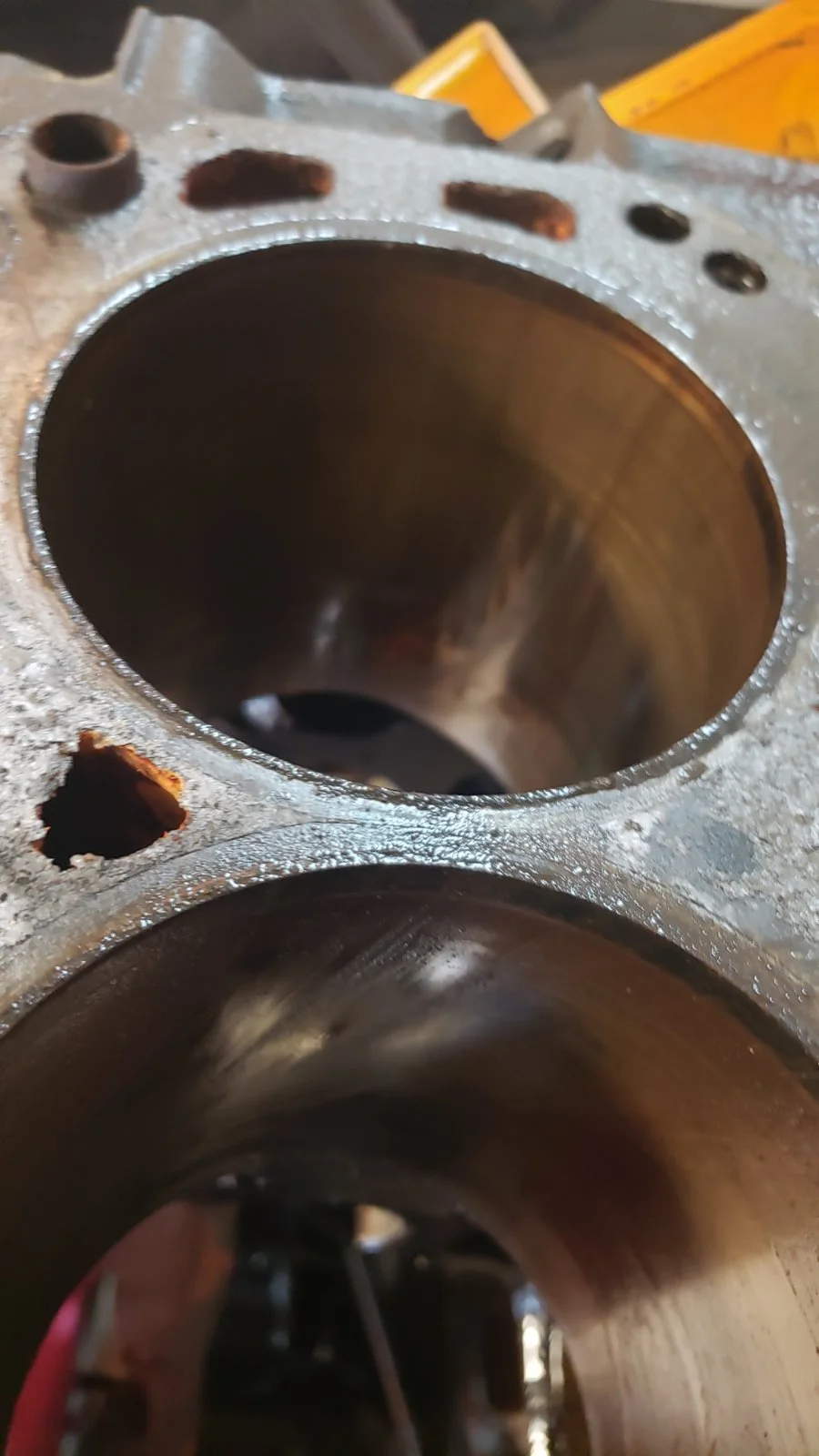

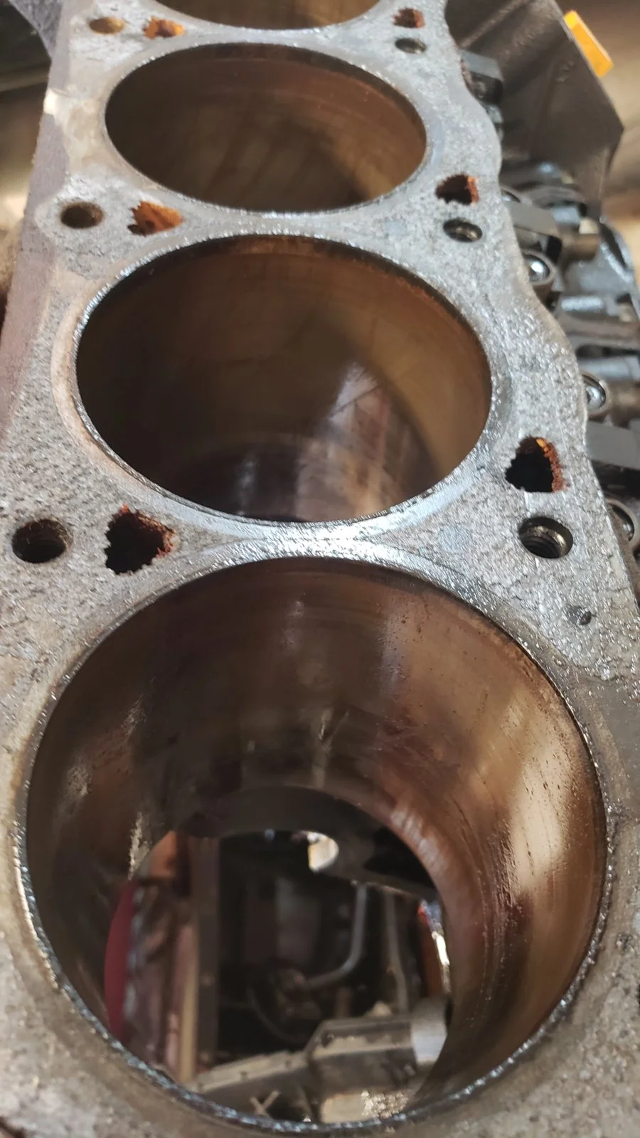

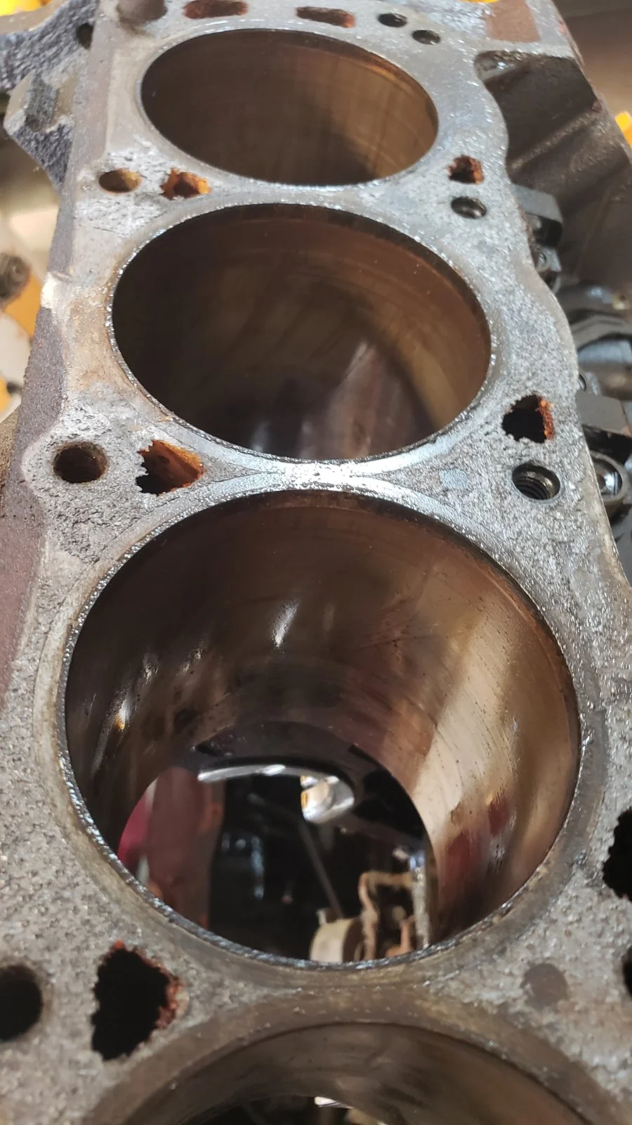

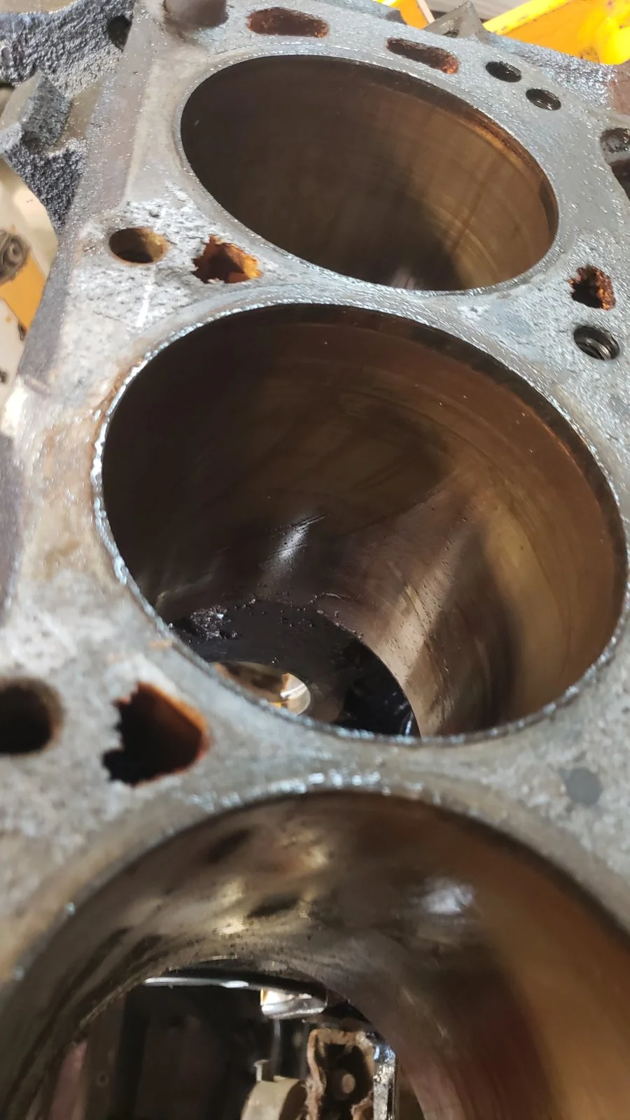

Here are the cylinder walls. I disassembled everything and then knocked the pistons gently out the top from the bottom. What do you guys think about it now. I will get it bored 30 over.

Glad you got it apart. Looks better than I thought, too. Might clean up OK.

That looks better than I thought it would too. What about the front cylinder in pic #5, the area about 1/2-2/3 the way down the cylinder at 3 o'clock in the pic? Is that pitting or is it just a bunch of crap on the cylinder wall? It's hard to tell in the pic, but it looks pitted. If it's pitted that'll determine how much you can have it bored, but from what I can see a .015" cut won't clean that one up so it may need sleeved. Otherwise they all look a lot better than expected given the original pics.
Just a bunch of crap on the cylinder wall - no pitting
