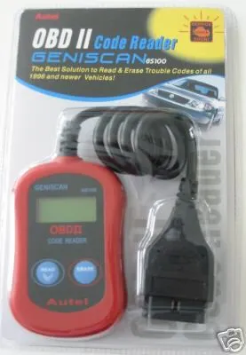

Thanks for the info! I've just ordered one from eBay, it's just a code reader/eraser, I got it for $46, hopefully it's good.
Cheers :cheers:
