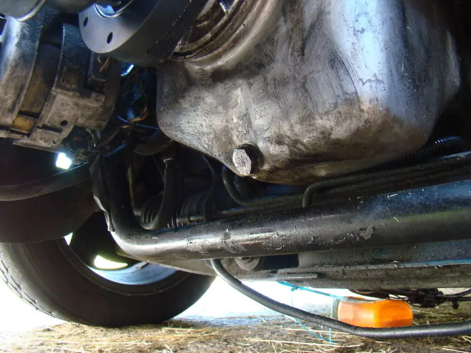

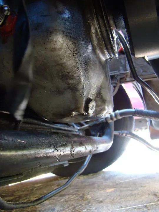

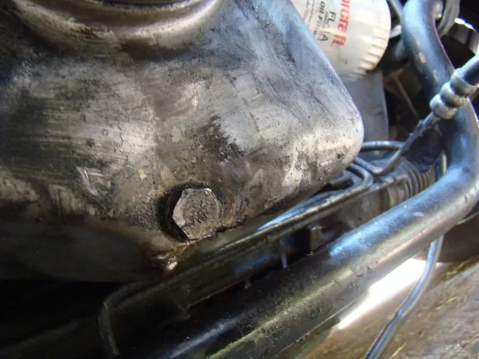

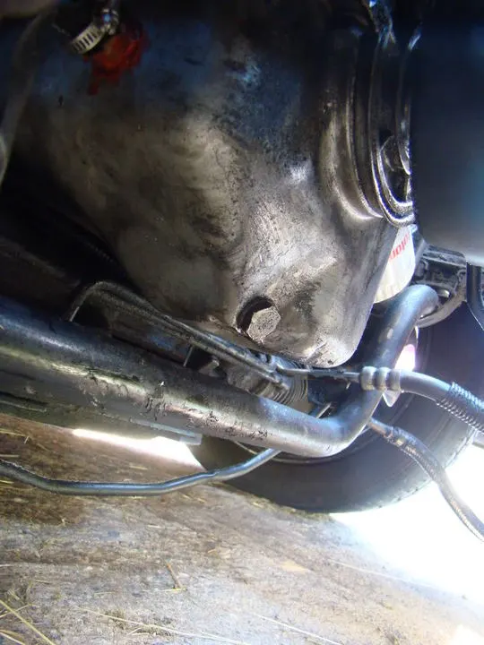

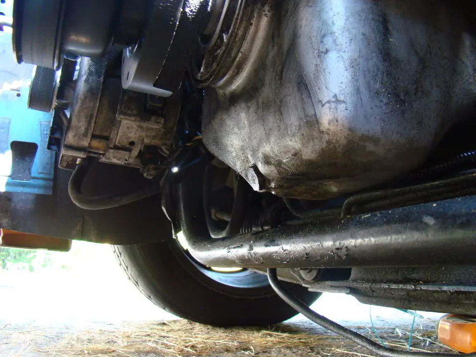

Ok I got to looking under the car to check for any visual damage from the Harmonic Balancer/ SC crank pulley breaking and falling from the car. The reason I thought there might be some damage is because when this happened somewhere the HB got wedged in the front of the car and lifted the front of the car off the ground for a split second( or it seemed like it did) so I noticed a ticking sound (like an exhaust leak) when I was driving the car home. I put the Stock crank pulley ( NO S/C) to atleast drive the car home. The car drove good and seemed like there was nothing wrong. Sounded the same and ran good considering the car was running with no SC but I did not drive the car hard because the car is tuned to run with the SC...anyway I got to looking in the front of the car and there is this HUGE dent in the front of the oil pan where the drain plug is. Now my question is will this hurt anything leaving it this way until I can get another oil pan some time down the road when I pull the motor ( not telling WHY I am pulling the motor hehe)? Here are some pics that I just took a few minutes ago of the dent

That is not going to cause any issues. The oil pick-up area on the pick-up tube is on the other end of the oil pan, towards the rear.
yeah I knew that I was just wanting conformation that there wasnt any harm there. I knew that the oil pump is right next to that though. Would suck if it hit that and bent that tube or caused it to leak and lose oil pressure. I am having a hard time keeping oil in this thing as it is since i started running synthetic
I was looking at how close the dent is to the plug. You may want to on the next oil change run a bolt up there and see if it hits the dent. If it does you may need to use the bolt to help move the dent downward to give clearence incase it will not allow the drain plug to seat.
