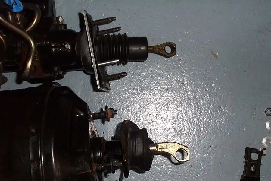

By looking at the other thread about Cobra 03 on a SN95, i looked the entire thread and the swapper says that the Hydroboost has a difrerent configuration on the pushrod. Take a look
http://www.theturboforums.com/smf/index.php?topic=34314.msg459554#msg459554
The poster below this says that cutting the Vacbooster pushrod and soldering to the hydroboost have worked with him.
Other than that & the hoses fabrication it can be easy? :shrug:
EDIT :
To avoid registration to the forums just to see the pic here it go
