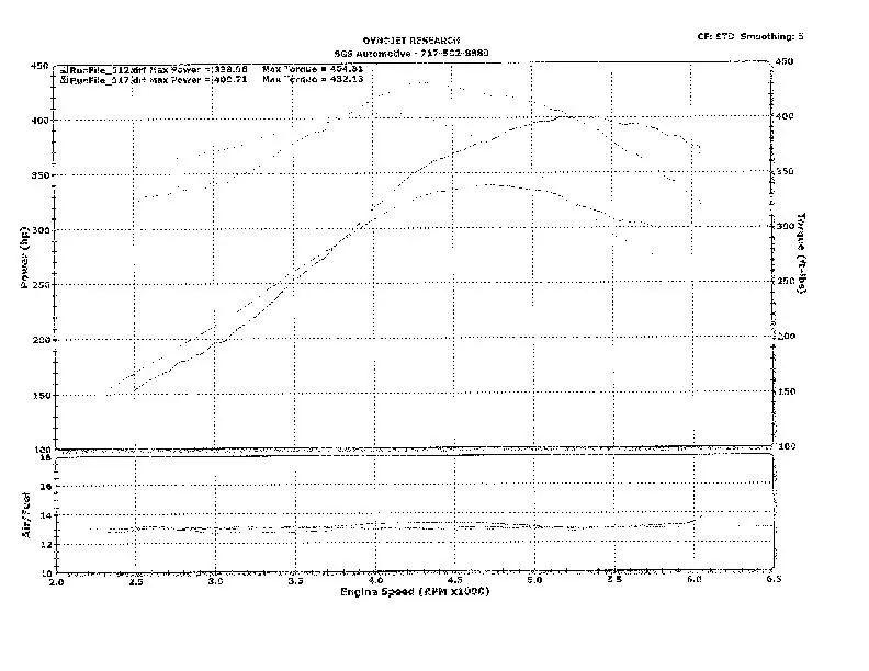

This is not the first time I have seen results like these from a similar swap, to AFR 205's.
It is funny how the volume is less, but the power is substantial in difference. The design of the heads is top-notch.
Anyone that says otherwise is just trying to sale another brand.
Your TQ loss at lower RPM's is likely to be attributed to the camshaft being spec'ed around the old 210's.

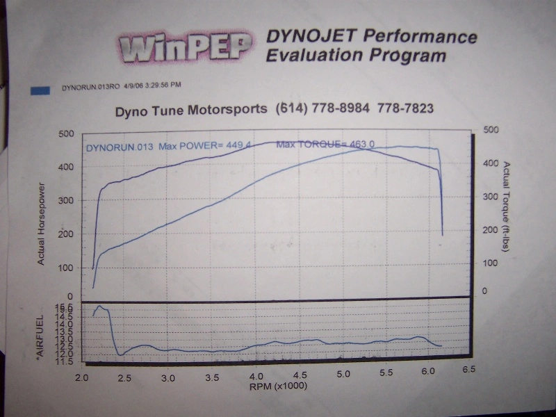

Here you go!
Accufab said shorty headers are literally worthless on my c.i. That's where I think I am leaving most the power on the table down low and higher. the mid-lengths I am getting are what the old 60's muscle cars used at the tracks. Long-tubes are super but for race cars. I am a steeter not track. In fact I may never go to the track.
So I am prolly going to hate scraping and dont want to go to the trouble of cutting out the body although a cool option. I was going to change to long-tube and decided not for the streetability reason and ease of install and my usage of the car. I realize I might be giving up 15rwhp @>5000 but I am ok with that. So if I get better performance 2500 > 5000 I am happy. Although I predict a 425+rwhp #. :)
p.s. I dont know who said it but put 302/351 parts on a car and get 302/351 c.i. HP. I have a 414 c.i. and need to put 414 c.i. parts on it. I tried the other way and it doesn't work. Something will always be holding you back!
Congrats on hitting 400!!:nice:
Low-5.0 is up on you @3k by 60 ft lbs, so do his headers scrape on everything??

Aw Damit......:chair: You're right I think. I do not want to do this twice. Ordered the LT's.
