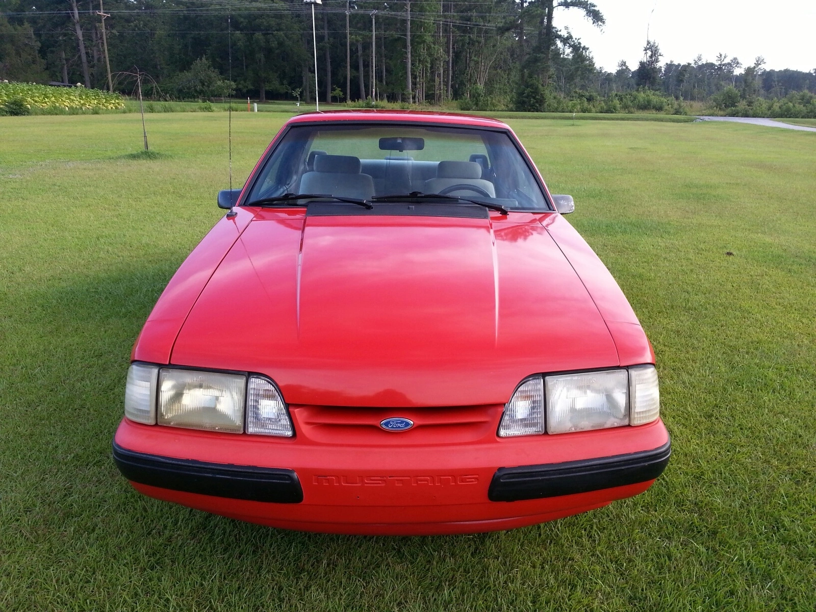

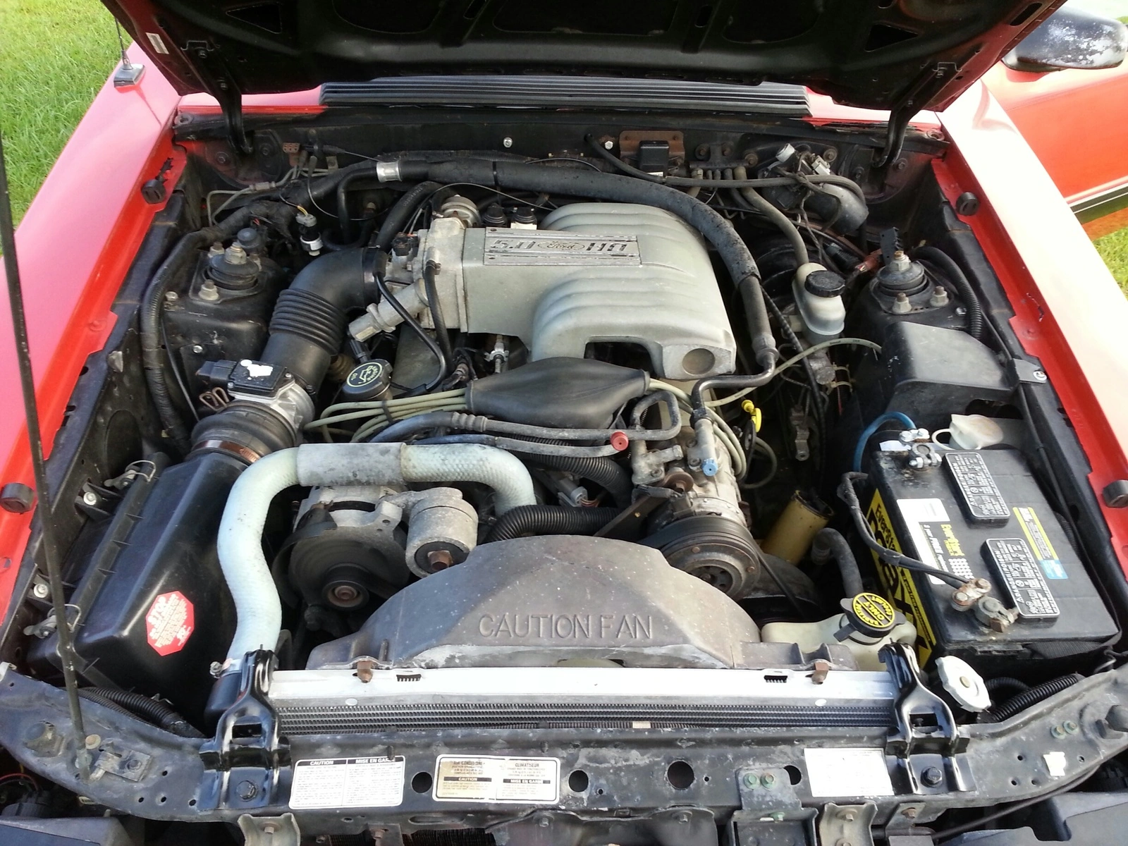

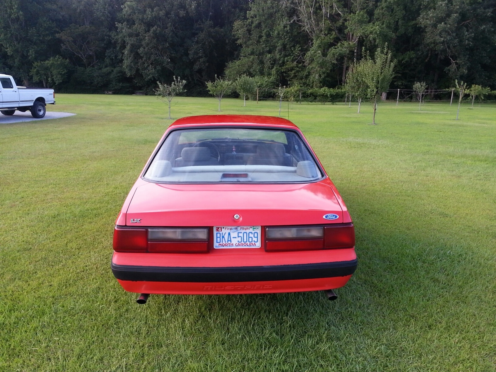

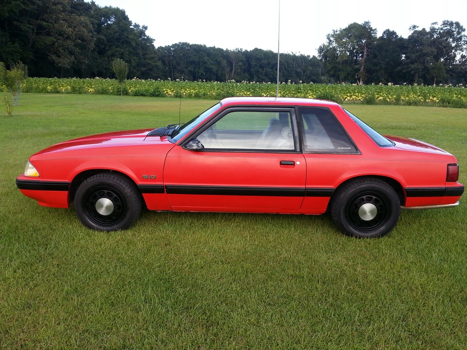

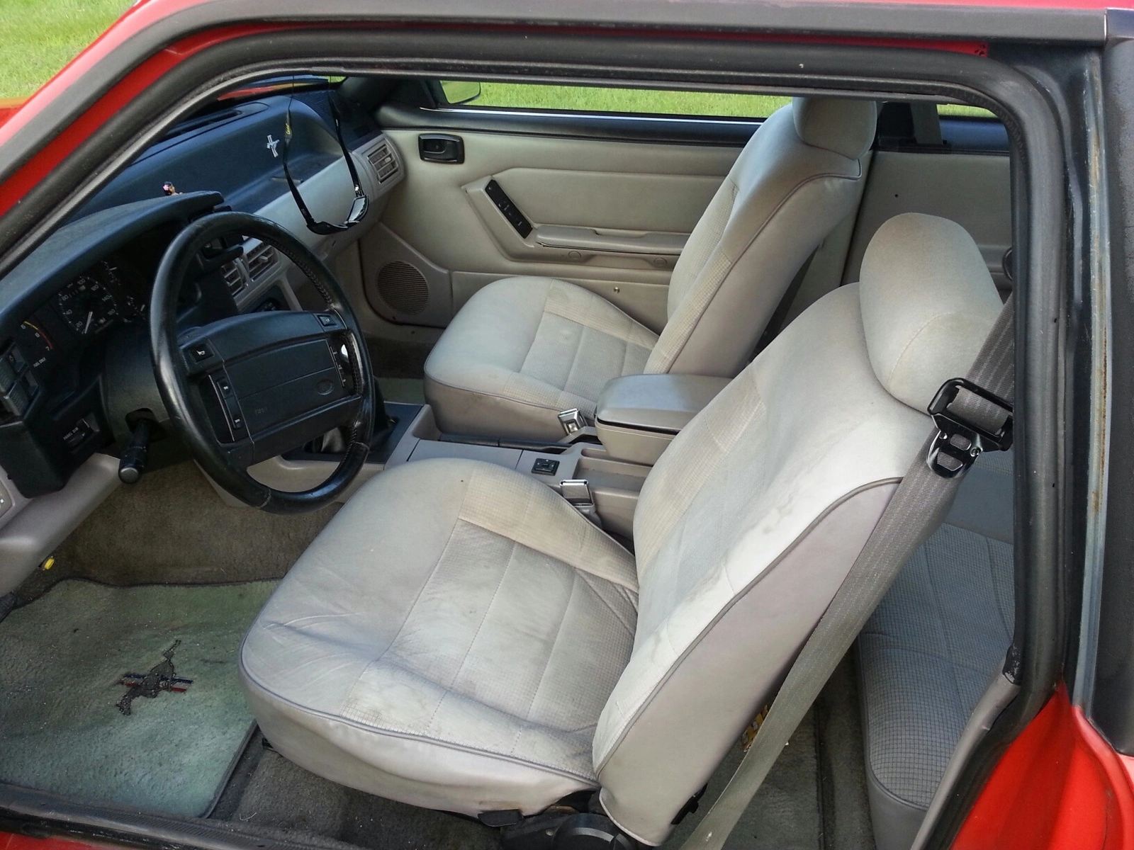

A few of you have been posting in my other thread called 'Stock fox body worth?' I have been looking for a couple of months, then decided to register on here to get more feedback about potential cars I was interested in. I think I turned 4 down since I've been a member here. Then I stumbled across a '92 SSP for sale. I am not going to lie, I never even heard of a SSP model before. I knew that they were used as police cars, but the term SSP was new to me. I did a little bit of research on them so I could know more about them. What really made me want this car was the fact that it was an LX body style and a coupe. They are hard to find(at least in my area) and that is what I really wanted.... I took the drive this morning and as soon as I saw it I knew that this was the one. It's not a perfect car. My main concern was it having a straight body, little rust and ran good mechanically, little to no mods. All of what this car has. I have not taken any pictures of the car but here are some the previous owner took. He also had another set of wheels and tires. The tires on the other wheels were a lot newer. Since I had to drive 180 miles back home I did not want to risk driving on tires that are cracks in them. The wheels that I have are silver.....
View attachment 82211 View attachment 82212 View attachment 82213 View attachment 82214 View attachment 82215

1. On the way home it started raining then raining harder and harder. Wipers stopped work. After tapping on the motor they began working again. I know I need a new motor, but while I was under the hood I noticed there was a smaller plug that looked like it was supposed to be plugged in somewhere, but couldn't tell where. The plug was grey and had to holes. I will post a picture once it stops raining.

No pics of it but ill bet the little gray plug is one of the ODB plugs. Good looking car.
You are correct.
