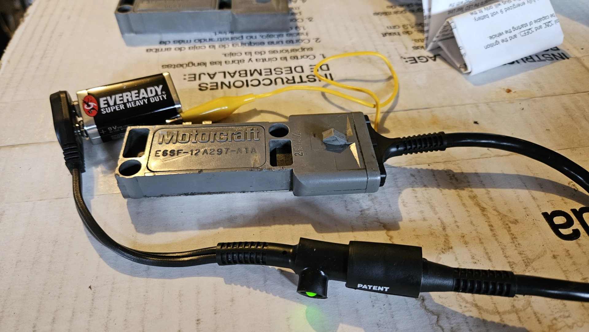

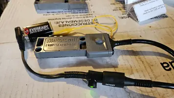

Since she crapped out, it could be your TFI Module starting to go. To check it Buy this from Ebay and don't forget to buy a 9 volt battery. Comes with instructions, when you plug in the tfi there should be a light green light that lights up and when your clip the clip onto the 1st pin of the 3 it should turn solid bright green meaning the tfi is good. Check out the picture. highly recommend every foxbody owner to buy one.
Check out KASTAR 271a For Ford Ignition Module Tester Tfi Edis 6 Pin EEC-iv USA on eBay!
