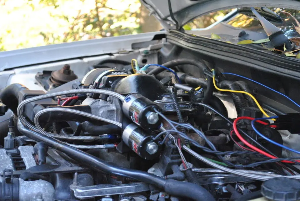

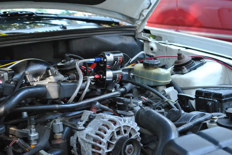

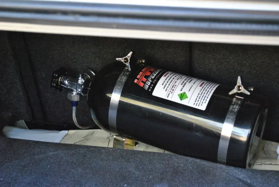

Here are some pics... 75 jets are loaded up and ready to go for the first shot.
Bottle mounted so I can reach the knob and see the gauge from the drivers seat. It's angled so the nitrous will feed to the back of the bottle where the pickup tube is.
Should have mounted the solenoids inside the bracket because of hood clearance, but this will work for now until I hook a purge kit up. In these pictures, the fuel is NOT hooked up. It is now, and was actually stupid easy to do. Hardest part of the install was getting the EGR hooked up since the plate raised the plenum, which is already taller than stock, and tapping into a switched 12v power source... used the convertible top harness, and it works like a charm. I CAN HARDLY WAIT!!! :D

Looks like a clean install with those new solenoid brackets they offer! Your gonna have a huge smile on your face the first time the nitrous hits!

Yeah that bracket is awesome as far as a clean install. I need to flip the 'noids so they sit inside it, but not before I spray it first...:D

Nice install job, looks clean!
Thanks man. It was a real clean install. I've never done anything like it before and was expecting it to be messier than it was, but those solenoid brackets help a TON! I need to zip tie a few wires together and it will look like it almost belongs there.

Something you can try to use to help with maintaining bottle temperature is putting a jacket/blanket over the bottle. I keep a fleece jacket wrapped around mine all the time. It helps it heat up faster and seems to maintain the pressure longer.
