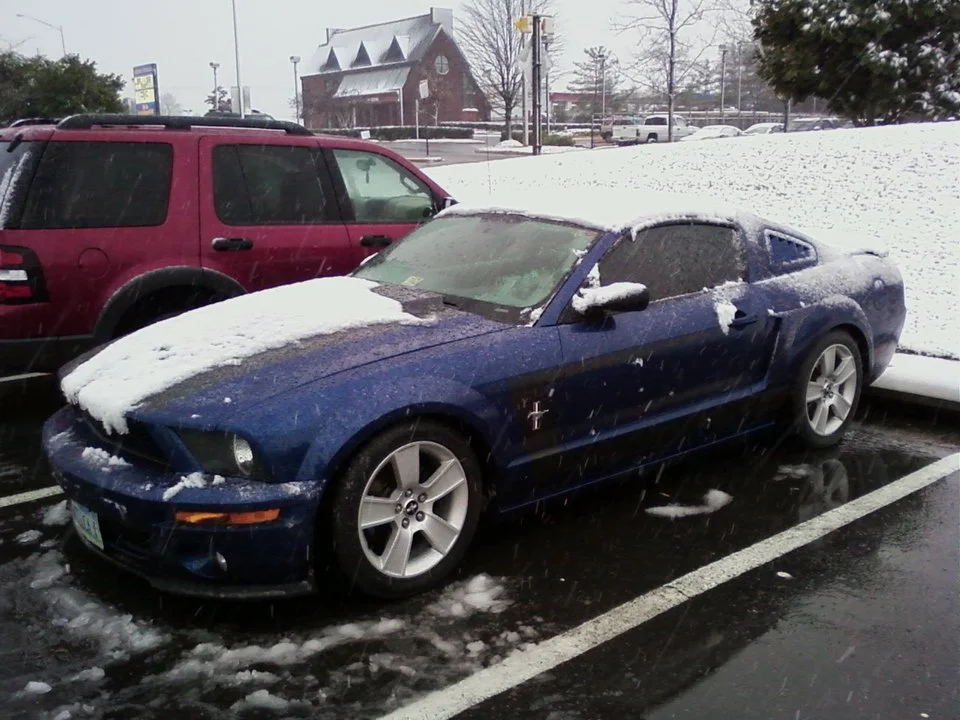

Nasty winter weather setup:

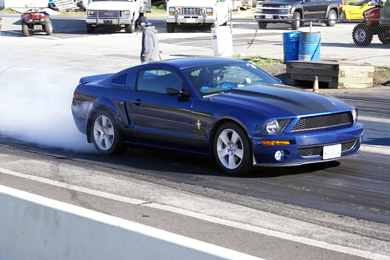

Drag strip setup:

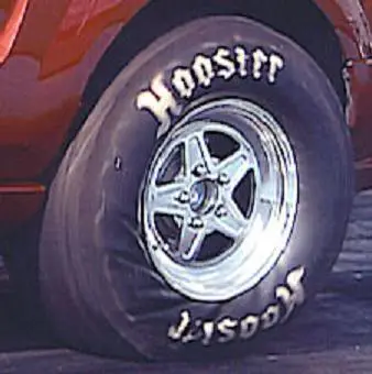

Close up pic of the Hoosiers under stress at launch

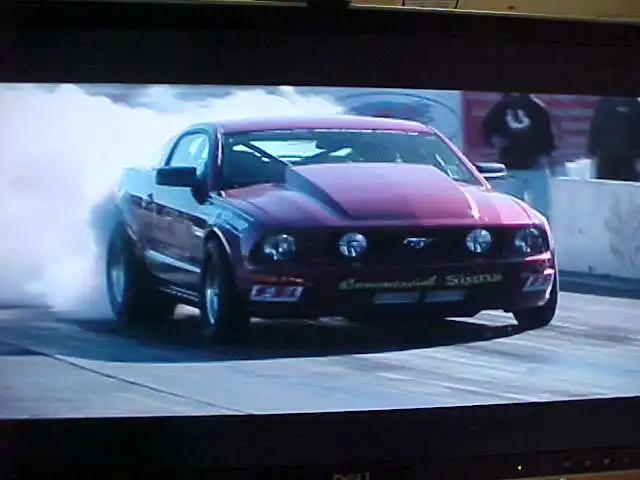

The MTs warming up

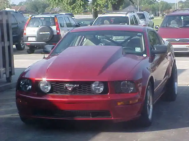

Pretty old pic of car with the 325 M&Hs, when it was still driven on the street
hey steve the 325 m&h pic, what size rim are they on?
i've got 325 nittos on my 15x10 i get alot of buldge. on your set up it seems like the opposite.
Nittos run small to their stated size, but M&Hs run even smaller! My buddy was running a 275/50 M&H on the 17x8 Bullitt wheel and there was hardly any sidewall buldge! Just the same as my 265/45-18 on a 18x8.5 wheel has very little bulge and looks to be the same width as the BFG 235/50:shrug:
He's right...the M&Hs run small. Think the rim was 17 deep dish. Still have them laying around somewhere. If the wheel well in the closeup pic looks jagged...it's because we had to do some cutting at the track, when we noticed the metal was cutting into the tires.
