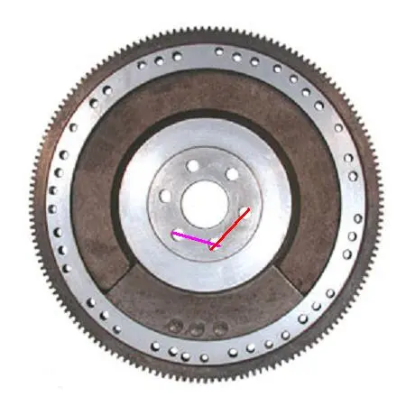

I didn't realise the Flywheel ( and I have changed many of clutches ) can only go on one way also...Hummmm...

Measure the difference between the two lines. You'll see that it will only go on one way. If you've "changed many of clutches", you should have realized this already.
