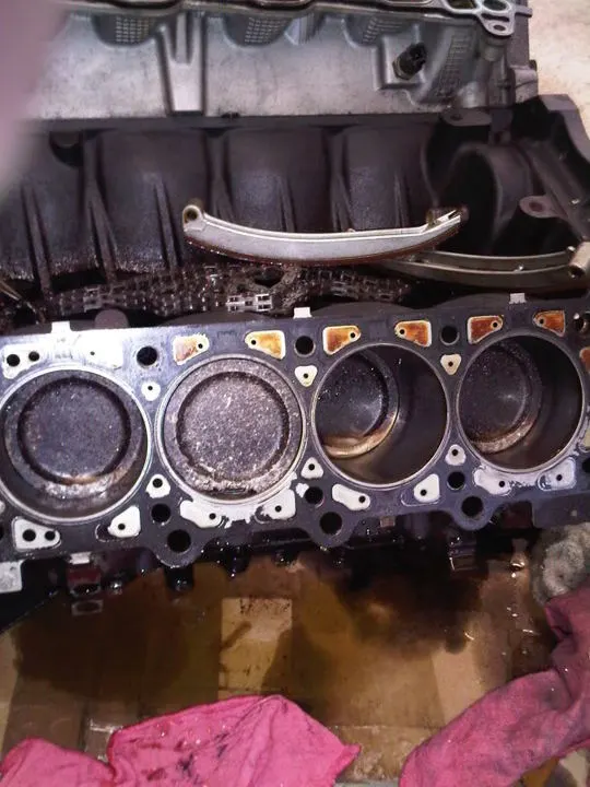

I remember one time I was gettin into boost up a hill and the next thing i know it started smoking and i heard something blow up. it was the PCV valve getting blown out of the valve cover. Anytime after that the PCV would blow out of the valve cover when i entered boost. and for a long time after running the car hard the coolant overflow tank would boil over.
Started knockin really bad and just running horribly after a while.

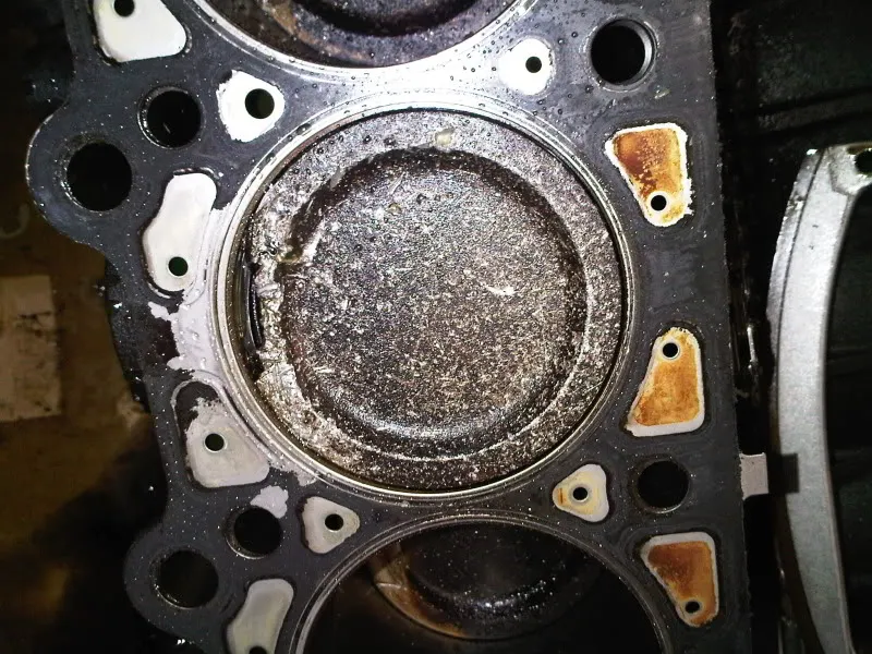

They're some crappy pictures but all but two of the cylinders have this kind of damage.
Yes it was "tuned"
I'm running 42lb injectors a high volume ford racing fuel pump with a kenne bell boost a pump attached.
Ya unfortunately this is a stock longblock, and yes the cams are NA. I bought them and used them for a couple of years, then decided I needed a blower.
I sort of blame the tuner for this. My dyno pulls went from 409rwhp, then he tuned it a little more, 421rwhp, and then tried to tweak it some more. Then on my last pull my throttle cable broke so I never finished the pull. He reassured me it would be fine. The AFR's I believe were tuned to 11:1. Dont quote me though, I haven't driven the car since around Christmas time 2008. :( Just
Just now got the motor torn apart.
Obviously it wasn' an ideal setup but I feel that it could have been prevented.
