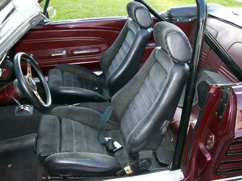

Today I got some recaro seats, they are bmw e21 recaro seats found in bmw 320i's.
Besides being the most comfy seat I have ever sat in, they took 15 mins each seat to install, I unbolted the stock bmw sliders, to my surprise my stock flofit/scat sliders bolted right on in the correct location just using the recaro allen bolts same bolt pattern and spacing as flofit and scat 16" on center, since I had scat elites in the car already they bolted right on to the #266 adapters.
Heres the way cool thing, they sit about 3" lower than my elites ( imeasured from my head to my roll bar), just as low or a bit lower than my stock lo back seats, they fit absolutely perfect in my 67 vert, even the door pulls dont hit the seat, you would think they were made for an early mustang and the stitching pattern on the seats is very close to the stock pattern although I'm going to have them done in leather. No modifications needed!

more
These seats fit great, I measured from my head to roll bar 3" lower than scat procar elites, I am going to have them done in leather and maybe change interior to black. I'm 5'11 and 220 and these seats fit like a glove and no modifications.
They are found in 77-83 bmw 320i's and say recaro right on the seat tracks, I looked at some new recaros for 900+ each seat and they were incredible, I have seen them in pick-a-parts for cheap, on craigs list but they go fast. I eneded up paying 500.00 for this perfect cond pair out of an 83 but they can be had for way less and then again I have seen restored ones go for 1000.00 a pair.
I have had mustangs since 1975 and this is the perfect junkyard seat that uses readily avalable sliders and adapters that fit flofit and scat seats but sit as low as stock but give you a german engineered oem seat that has saftey and comfort. They ene have adjustable thigh bolsters which when extended give you even more steering wheel to leg room and more comfort on long drives. I am going to re do them in leather in the original pattern.

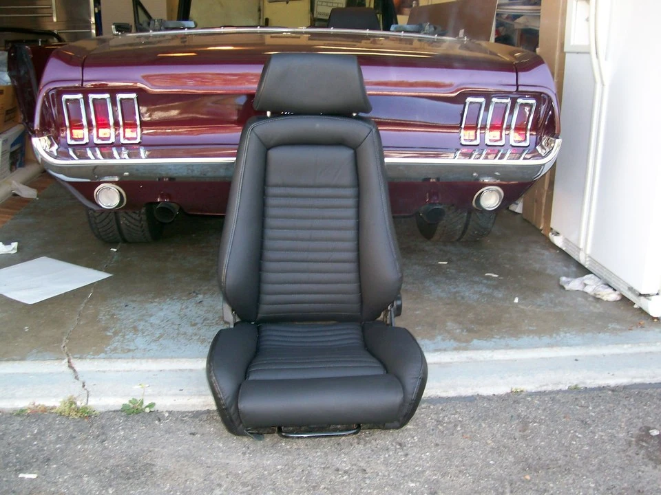

They look pretty much like the Fox Recaros. I had a 79 Pace Car Replica and bought a pair of Recaros from an 80 Cobra then had them upholstered to match my 69 Cougar. At the time early Mustang mounting brackets were available for the Recaros which made installation extremely easy.
Thats not bad at all. Those seats look fantastic now. Good job man !
