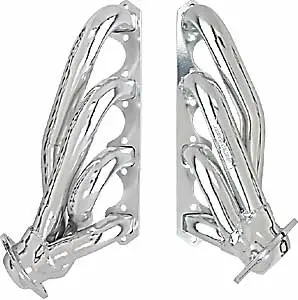

Ford Racing headers from Jegs. Jet Hot with lifetime warranty! $299.00 never need to buy another pair again.
Dayum sleeper... I wasn't even looking for headers and I'm sold. Any clearance problems with those?

None. These headers are new redesigned ones that fit the P-headed cars and fit stock heads as well (just more room for plug wire clearence). They are the best quality I have seen and they have thick 1 peice flange. they are stainless steel and "Jet Hot" coats them with their "Sterling" finish and give them a lifetime warranty. http://www.jet-hot.com/pages/headercoatings.html
Well worth the money. :nice:
