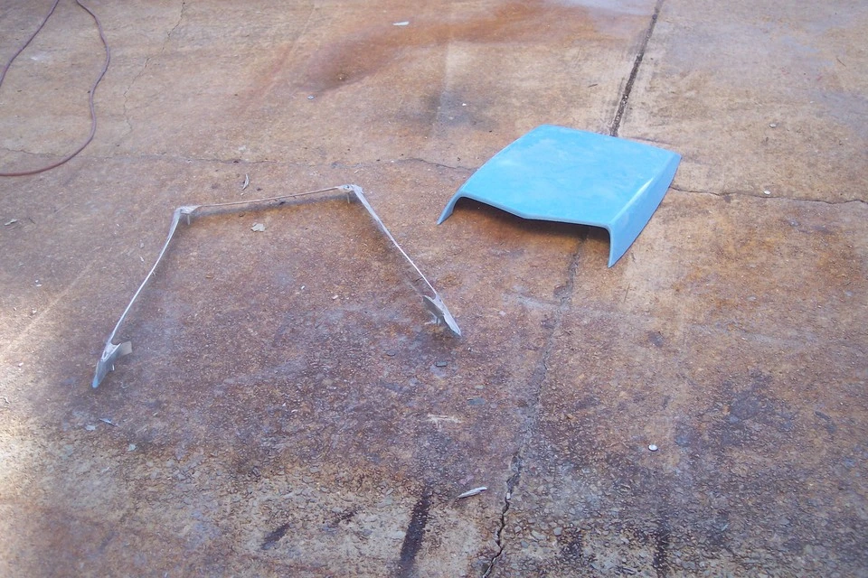

Nobody is picking at your car anymore than normal. When I asked what people thought of my hood scoop in it's original version, and people wanted to know if I'd rent them space out to park their garden tractors under it, I took the hint, and cut it down.
Now I didn't have to do that (obviously), but when I post my pictures asking for opinions or advice, and the overwhelming majority tell me to do something else, I can either heed that advice, or tell them to f uck off. But if I'm gonna do something, post it on a community forum, ask for opinions on my latest "addition", and then ignore what people think or say anyway, I might as well not post them.
DON'T GET ME WRONG. I get that it's a transition work in progress, and I get that it's your car. If you like that mega cowl on your hood, then that's all that matters. At the same time, just because I rib you about it doesn't mean you should immediately go out and cut it down or throw the thing away. The fact that I called your big assed cowl the Eisenhower tunnel isn't the worst you'll hear until there is something under that pin on hood other than the 2v that currently lives there.
