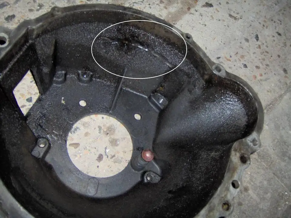

i just finshed putting in a new clutch now problems
How did it hit the bellhousing? Did you use the flywheel alignment dowel pins in the flywheel. It helps align the pressure plate. Even if you didn't the 6 bolt holes should line you up.
That is strange:shrug:
the kit didnt have any dowel pins but it was on nice with the bolts, when i compared it to my stock pressure plate there was a big difference on the ends, and thats were it was hitting
