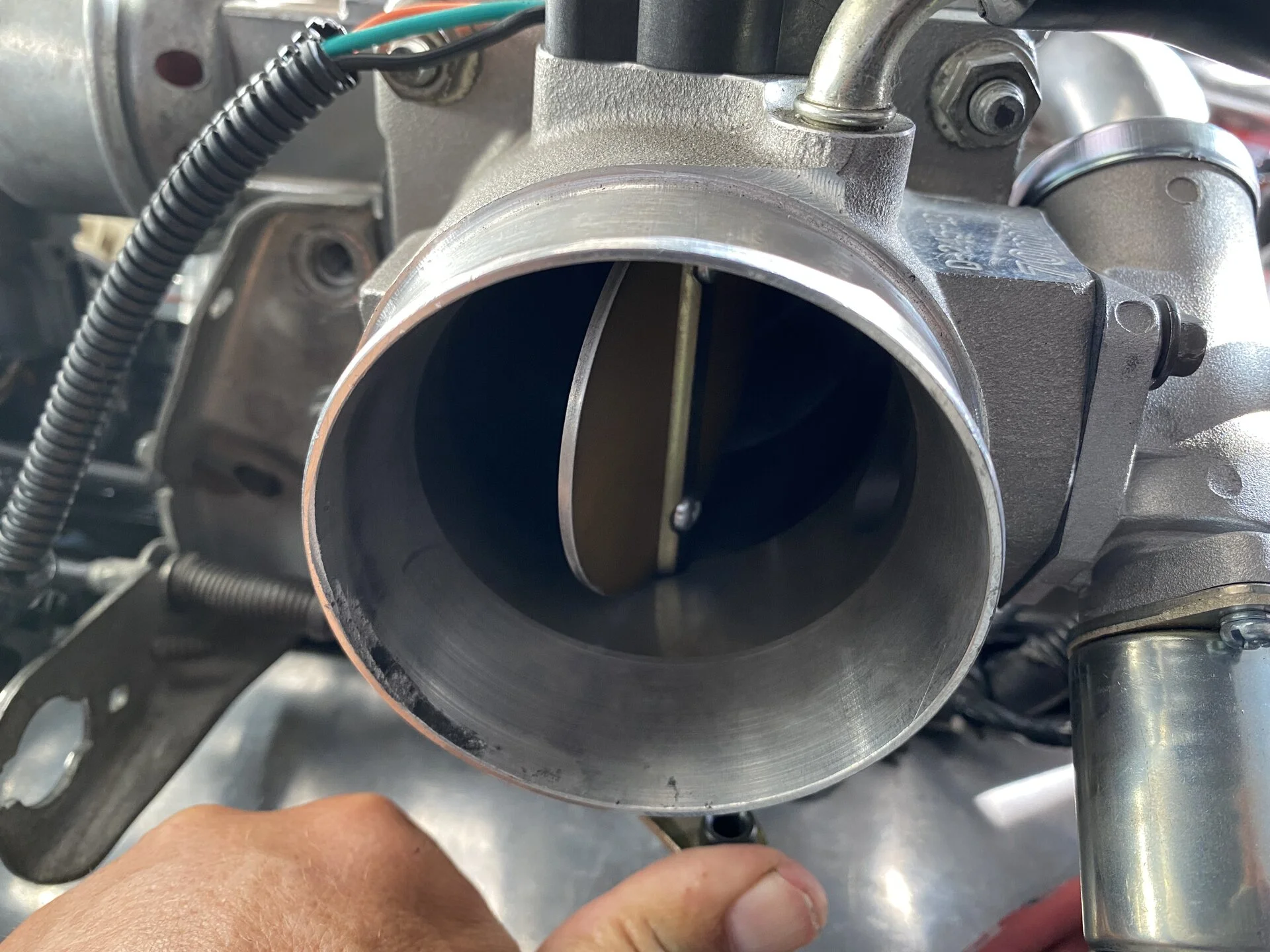

Throttle only opens like say 3/4 of the way so thanks for your suggestion.
The gas pedals are known to bend the metal is bent on a U shape. It should be parallel through the bends. If it bends it'll put the peddle closer to the floor.
That probably isn't your loss of driving hp. It'll only affect wide open throttle.

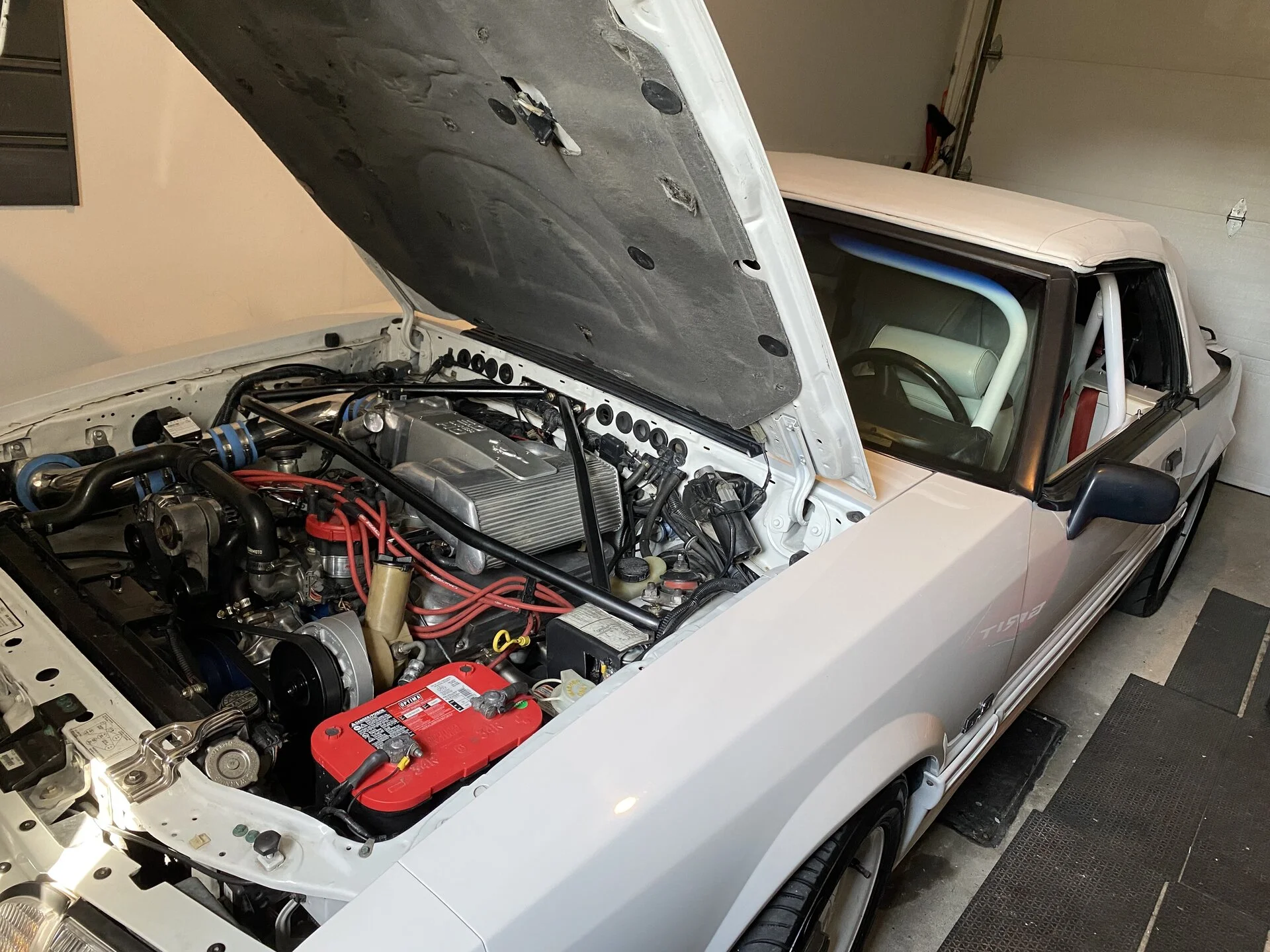

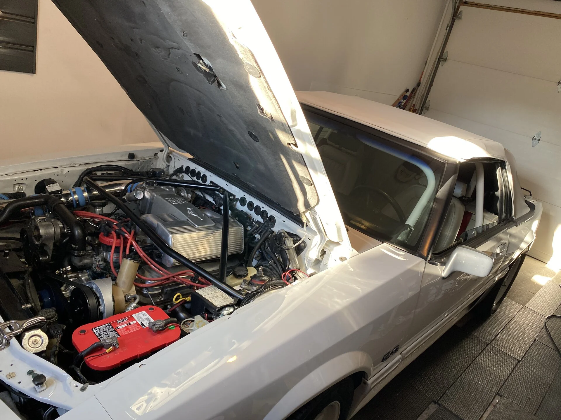

Hi me again, well now the car won’t start and i got no more engine light in the dash. I tried reading the codes and i don’t even have an Engine light on K on E off. Nothing flashing. You think the computer is dead ? The throttle thing ended up in the carpet forming a pillow underneath the pedal. My issue could of been the computer the entire time and now decided to completely die. For a very long time I couldn’t adjust the tps voltage or stabilize it even with new ones. Computer started going bad ‍♂️ And is dead?

Check your wire harness bulkhead connection. You dash roll bar goes through the area where the wire harness goes through the firewall. It sounds like you knocked off a ground or loosened a plug. Check especially where you cut the holes for the bars both sides. Looking at the pic of the passenger side interior I see wires dangling right by the roll bar where the computer lives
