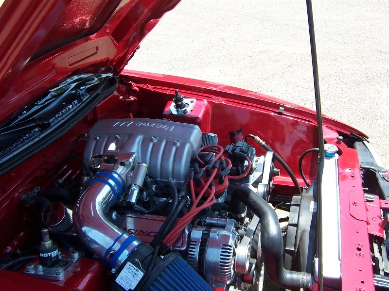

I'm getting ready to install my AEM in a week or two, and I'll be switching to a MAP system so the MAF and filter have to go. So what would be the best way to do this?
Here's what I have now
It's a rig job I did with a piece of my old CAI. I meant for it to just be temporary, but I never got around to fixing it. Anyways, I read on here at some point that a short intake tube with a long filter showed the best performance, so I was thinking of getting one of those long skinny K&N filters and putting it in place of the MAF/filter setup I currently have on there. I think that will be the cheapest easiest solution. I also don't really want a CAI with the filter hidden in the fender well because then I would have to cut up my engine bay.

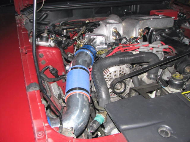

Why would a CAI cut up your engine bay? Wouldn't you just mount it in the existing opening as I've done.

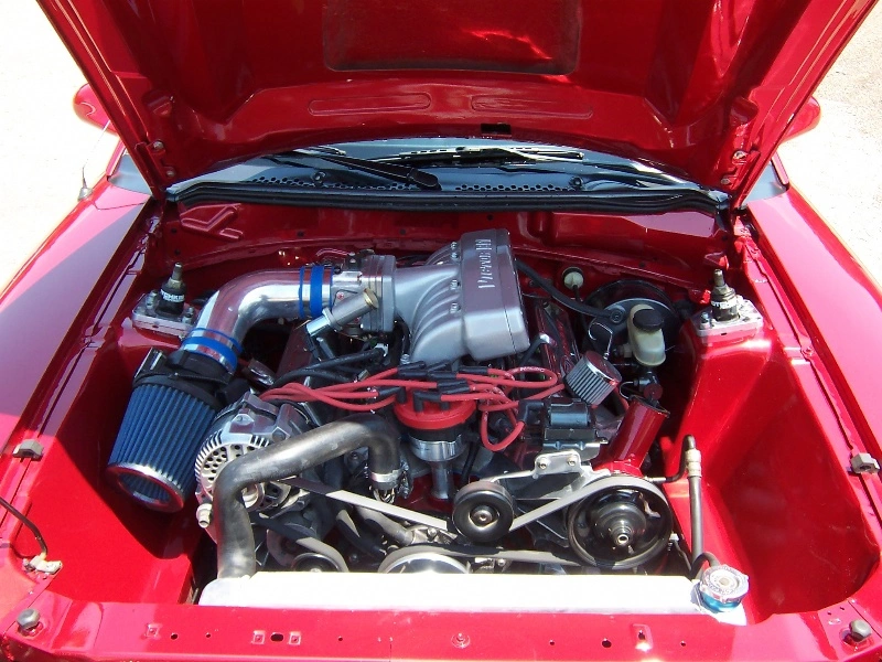

from the looks of it,he filled in all the holes and hid alot of the wires in the engine bay.
maybe he closed up the hole where the original intake drew it's air from

Yep, no MAF and smoothed engine bay. I suppose I should have posted this pic too.

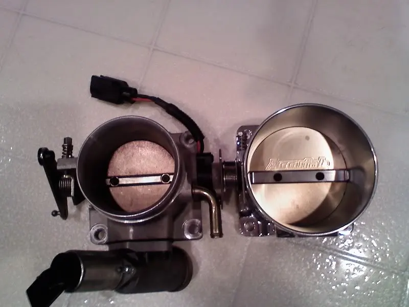

I think you would gain more than that. Honestly I've looked at your sig before and thought to myself "Damn, that guys car should run faster". Theres no excuse for your car to not be a 128mph car in the 1/4th. Now I don't know how big of a cam Ed gave you and I also don't know your tracks elevation but if everything is in check you should be alot faster. You have got a huge motor, huge heads, huge exhaust, and you are restricting it with a 80mm MAF and a 80mm TB. Makes no sense to me.... Here is a pic of my 90mm Accufab next to the 70mm Eddy.
IMO this is your bottle neck. I also wouldn't worry about how many ponys you pick up I'd be more interested and the changes it did at the track.
