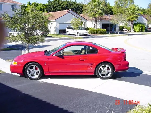

My '97 with H&R street springs:
I've used H&R & Eibach, & I prefer the H&R's.
