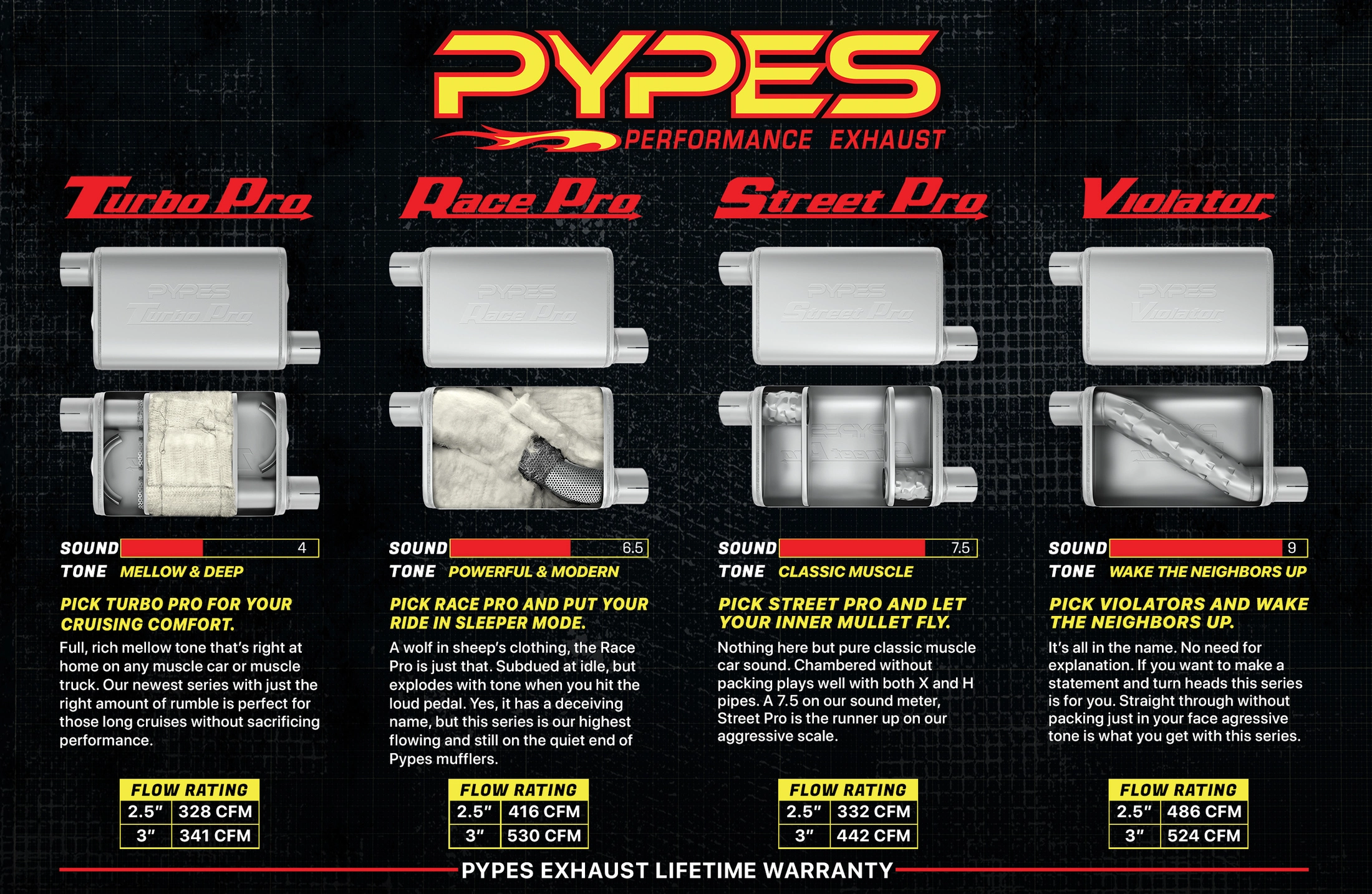

Im really interested in the new Pypes Turbo Pro baffled mufflers. They copied the old Dynomax baffled mufflers you can't get anymore... loved those on my 83.
