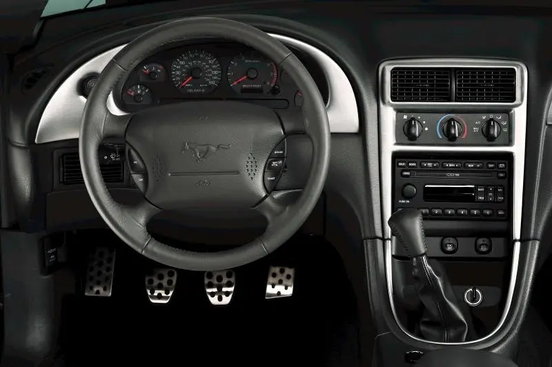

I thought those only came stock on the Mach (IUP) and Bullitt? It was an option for the '01-'04 GT?
I believe it was part of the interior upgrade package (somebody correct me if I am wrong). A pic can been seen here, from the 2003 Mustang Brochure. It appears this interior is a stock GT interior based on the speedometer at 150 mph (V8) and the non-Bullitt/Mach 1 cluster.
