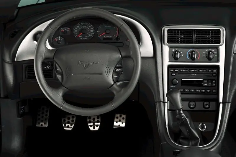

I believe it was part of the interior upgrade package (somebody correct me if I am wrong). A pic can been seen here, from the 2003 Mustang Brochure. It appears this interior is a stock GT interior based on the speedometer at 150 mph (V8) and the non-Bullitt/Mach 1 cluster.
That is not the interior upgrade package. That's just some sticker overlay.
The iup came on 2003-2004 Mach 1, as well as 03-04 gt and v6 mustangs.

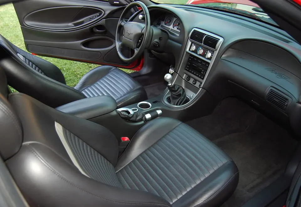

My 2003 gt with the iup center console (I added the Mach 1 shift knob)
