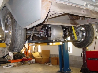

Check it out -- just got it done yesterday. I've got a set of coilovers for it; the temporary links where the shocks go simulate loaded ride height.
What do you think?

thats really nice and i applaud your abilities, but i think its gonna look goofy at the back with the brake rotors inward of the spindles. i mean isnt that the point of big rims? to show off your sexy brakes? :D
also, forgive my ignorance about IRS but is the halfshaft acting as the upper control arm too? if so thats pretty nifty.

Yeah, I'm curious to see what it looks like with the final wheels on. I'm planning to use 17" late model Mach 1 wheels, so it may look a bit empty in there. The brakes get better cooling airflow inboard like that though, and the real advantage is in the drastic decrease in unsprung weight.
Also, you're correct in noticing that the halfshaft acts as the upper control arm as well.

Interesting... looks like a pretty tall setup though?
Do you mean with respect to ride height? I set it up to be about at stock ride height, which is appropriate for the car I'm building. The rear shocks are adjustable coilovers, so I can lower it that way to a certain degree as well.
