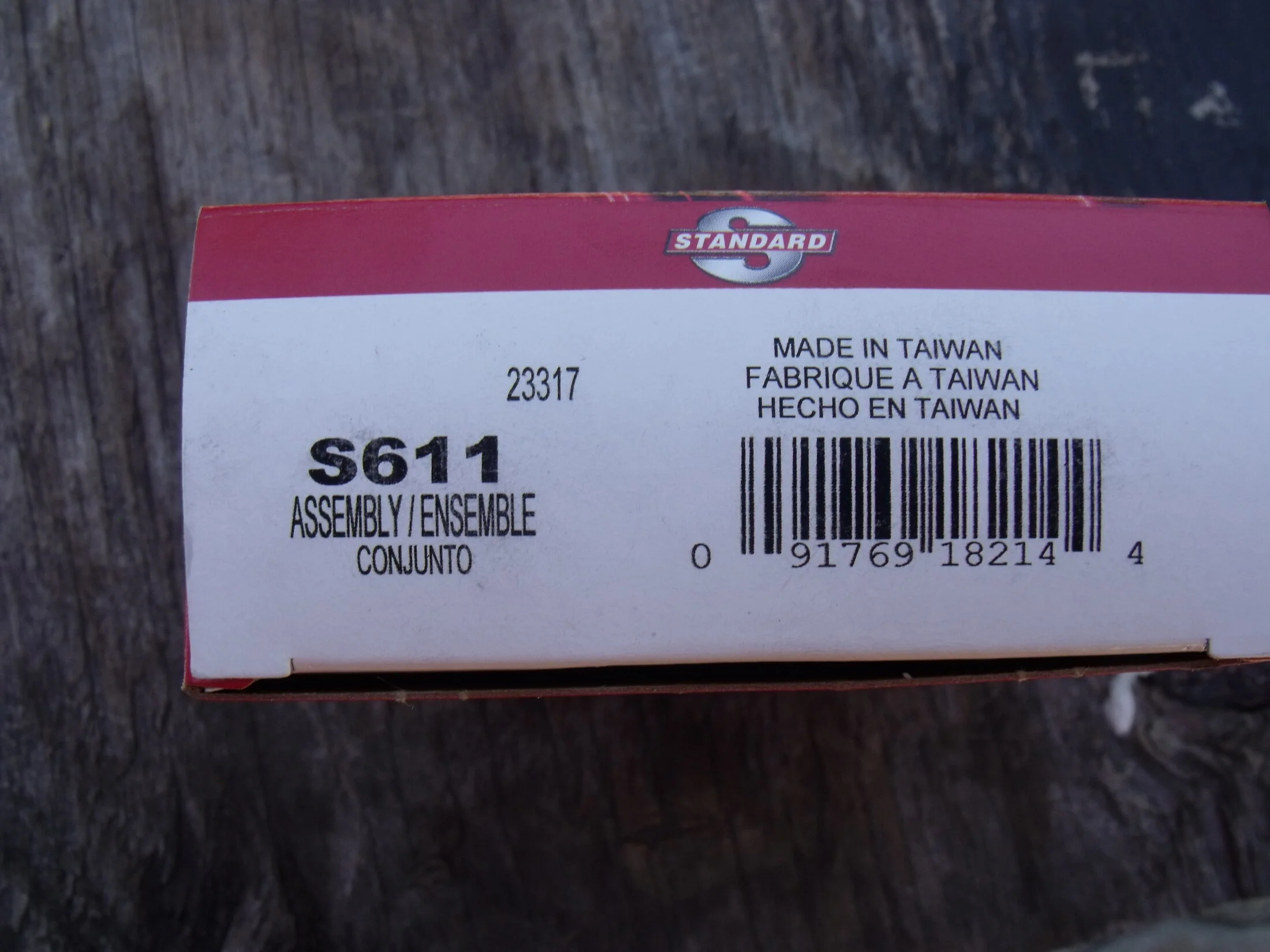

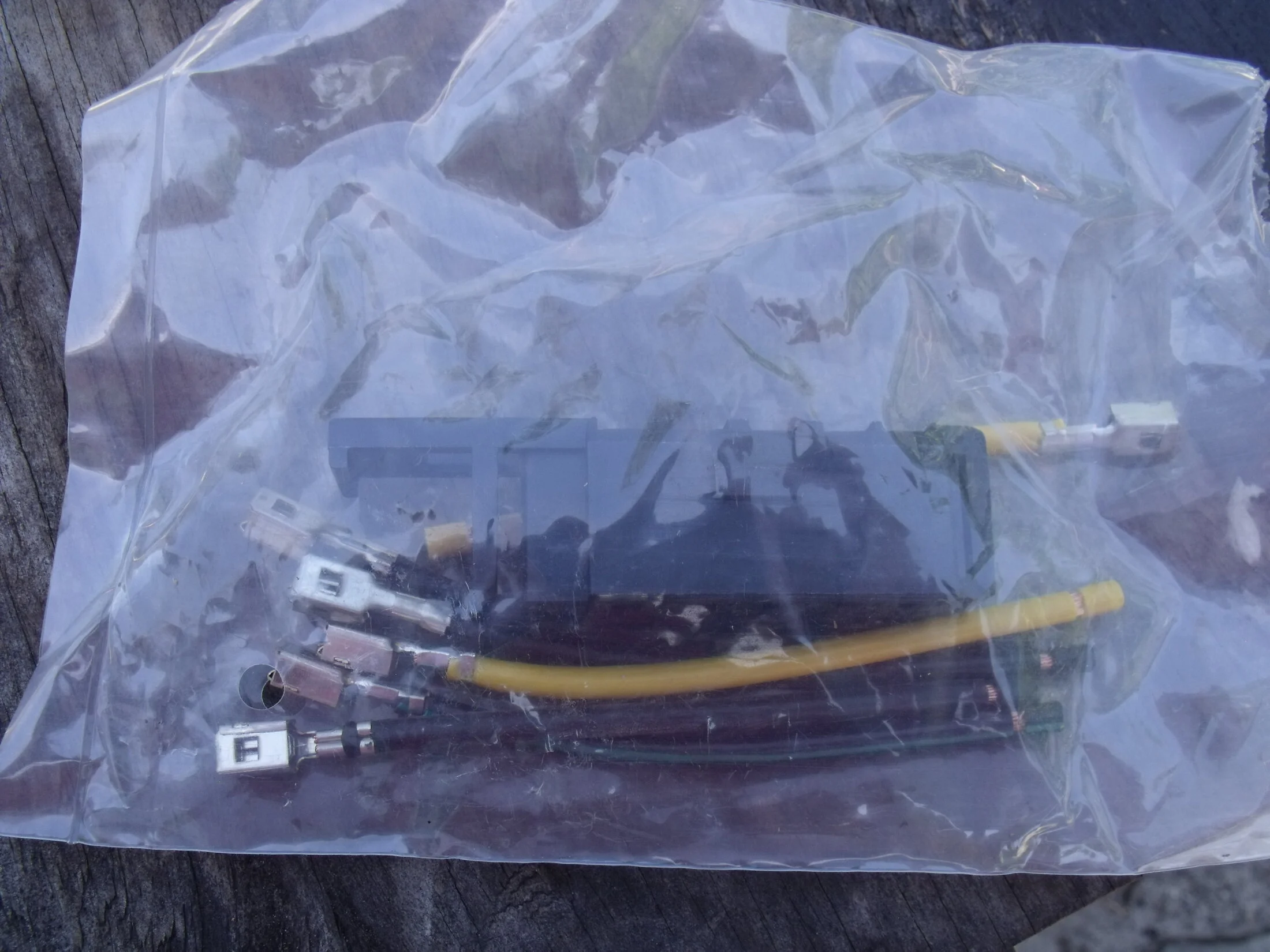

Bypassed the resistor wire that was getting hot with a new wire and everything seems fine now... No hot wire and no burning electrical smell...
I had to buy the entire kit from my local OReilly's to get a new metal connector for the connector that goes into the ignition switch.... To anyone else doing this here is the part # and the connectors are an exact copy of my stock one....
The Cars with the older style can coils had this resistor wire in the wiring system....
