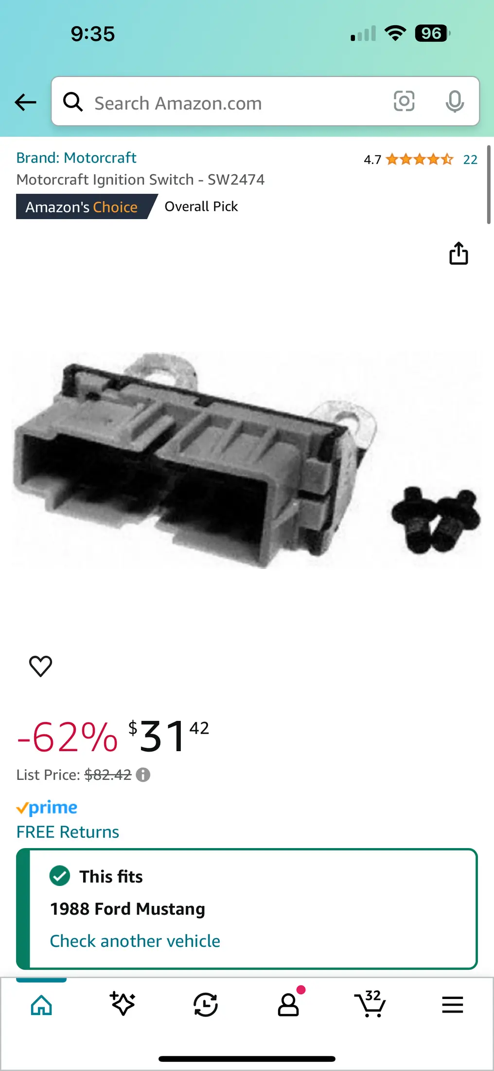

My guess would be these ignition modules are all made overseas now. What is oriellys return policy? If it’s divided by decent (and hopefully they have free shipping or something) perhaps you can order one to check out with the intention of returning if?
It’s also on Amazon for $31, but I have gotten fake parts from Amazon. At least their return policy is good.

The OReillys is 2 miles from my home that has it in stock... I thought about driving over to it and asking if I can look at it... IF its Made in the USA, I might buy it??? Retired guys have to think up things to do.... To old to chase women or drink anymore.....
My first thought has been to buy a $13 one to install to see if its my problem....
Think I would trust RA over Amazon for fakes.....

Are those the fasteners shown in the pic, that my car has? How are those fastened??
They are reverse (female) torx. I don’t know the size.
I have an old NOS ignition that happens to be one of the recalled units and it also comes with the screws.
Local hardware store might have a set.

Ended up getting the Amazon Motorcraft part, it will be delivered tomorrow between 4am-8am... The Oreilly motorcraft would of been over $80, this one will be $31.. If its some fake stuff it will go right back.....
Hope to find out if this will fix it.....
I will update this.....
How cool is this.... After ordering this Motorcraft Switch Saturday afternoon from Amazon, I wake up at 6:30am Sunday ( God apparently does not let old men sleep in ) and there is my part delivered at my front gate..... To have done that with Rock Auto, it would have cost $130 just for the overnite delivery..
Part looks good, Made in Mexico on the box, and FoMoCo cast into the switch itself.... No screws though...
After I type this going to Depot, it they dont' have the screws/bolts my " local " Hdwe store opens at 10am....
Some pics.. Old one is black.. Guessing it must the original with the ford part # and the " breakaway" theft screws still on it..Unless a Ford dealer would reinstall a replacement with these same screws??
