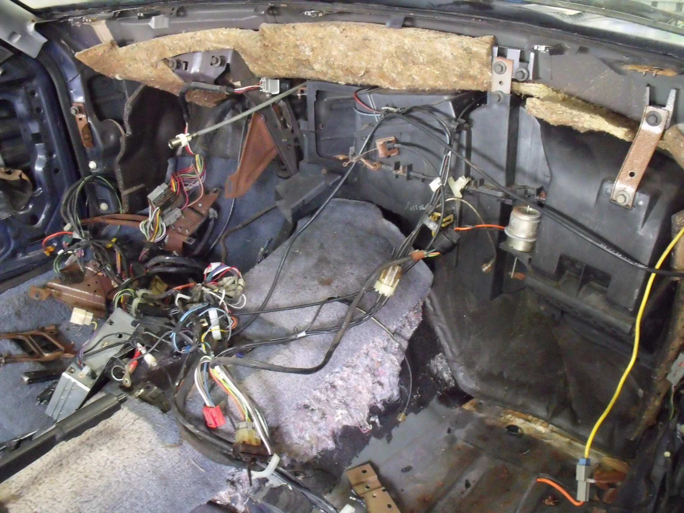

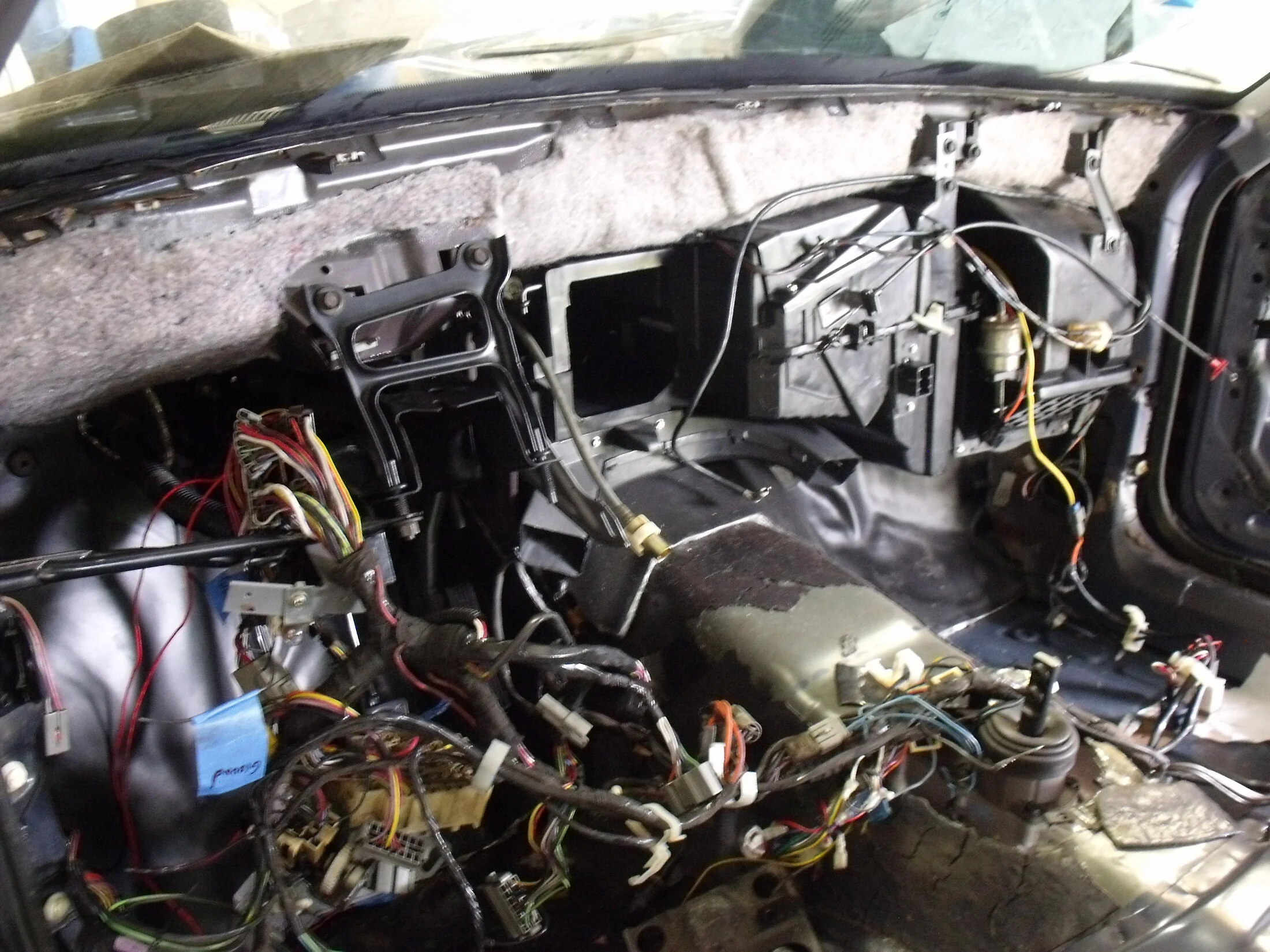

Did you have the dash out before?
Yes all of it.

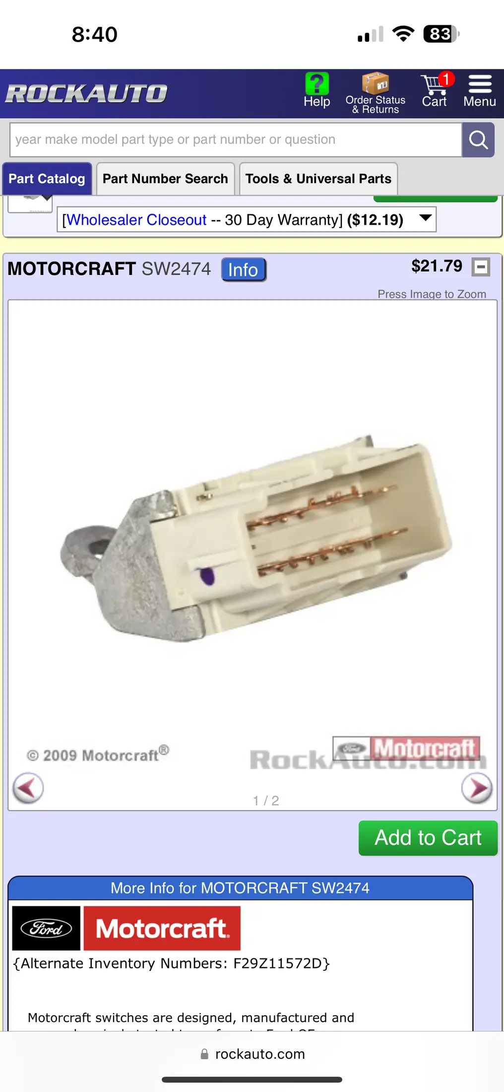

Hate throwing parts at problems, but thinking about replacing my ignition switch before I take out my dash panel or go further...
Are some better than others?
Prices range from $13 to $43... Wells is the most expensive, anyone used a Wells?
Found a motorcraft, but the pic doesn't look any different than the $13...
Forgot the brand but it has what looks like a heavier metal body, dark in color.... $23?

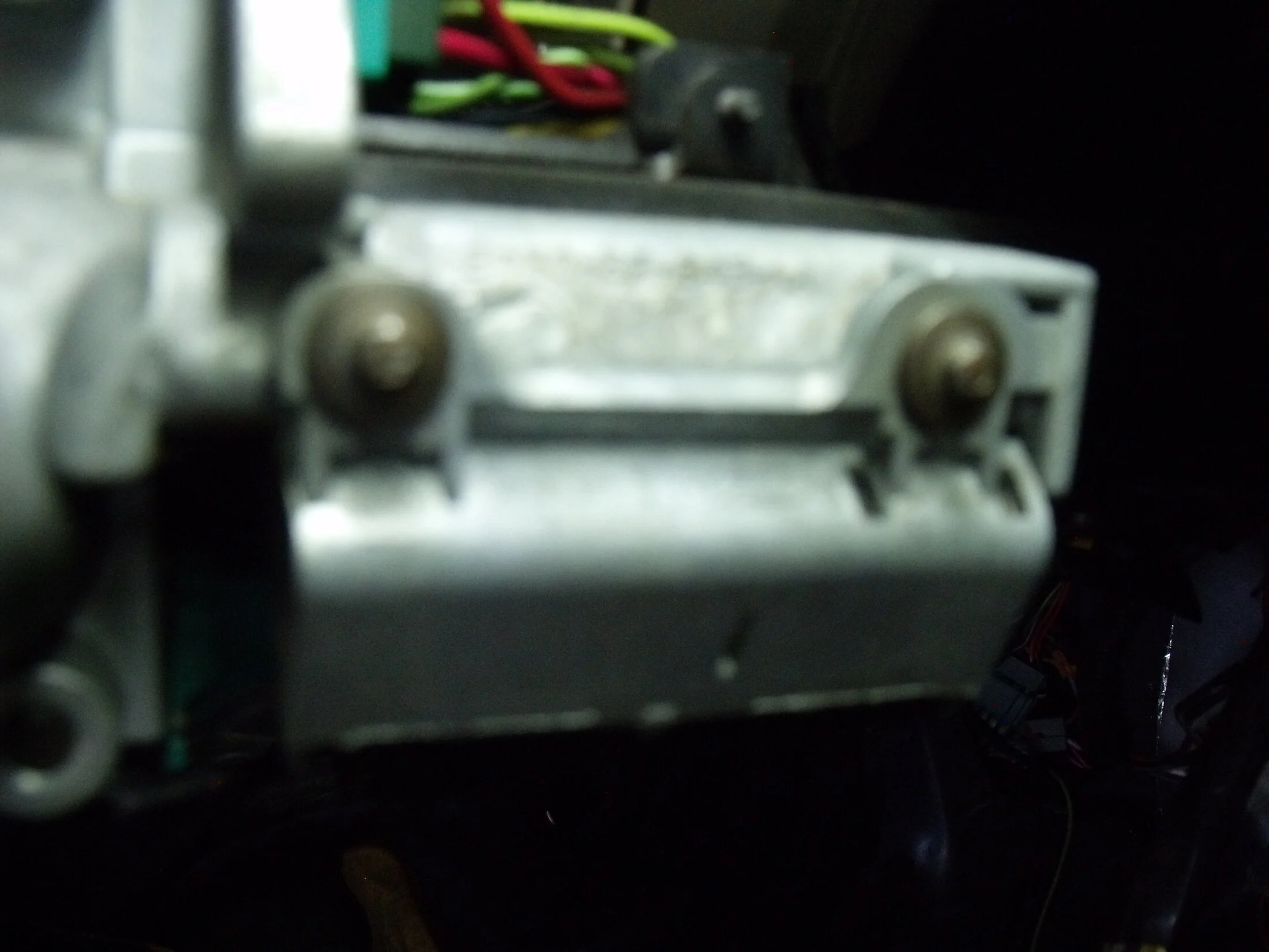

Anyone know how these come off.. Are they bolts I can turn out with pliers or vice grips? Or do I need to grind them off..
Cant find anything older than 87's about this on my computer searches and all they have are inverted torx..
As always, TY...
I used vise grips when I removed mine. Then went to the local hardware store (that is how long ago I did it) and just put regular bolts back in. Those are tamper proof bolts that the head snaps off of them when you torque them up.
If it was me I’d throw a Motorcraft one on. However their quality has gone downhill too.
