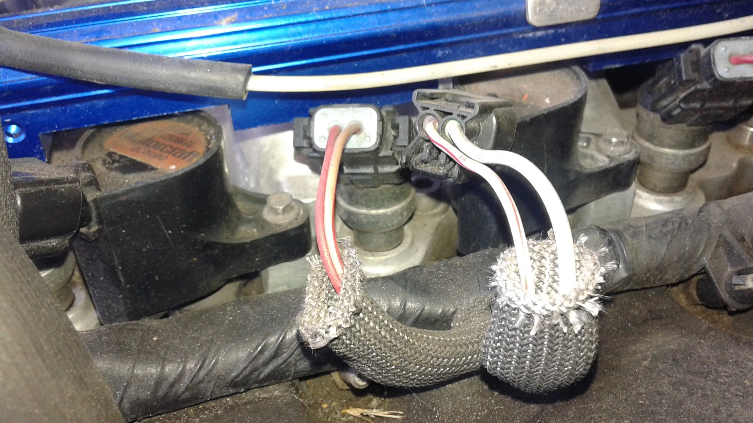

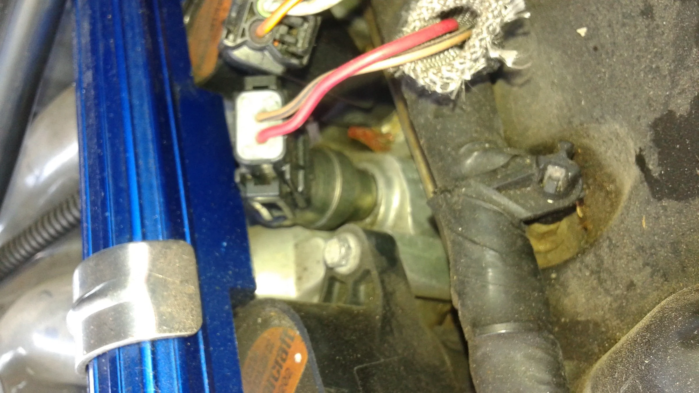

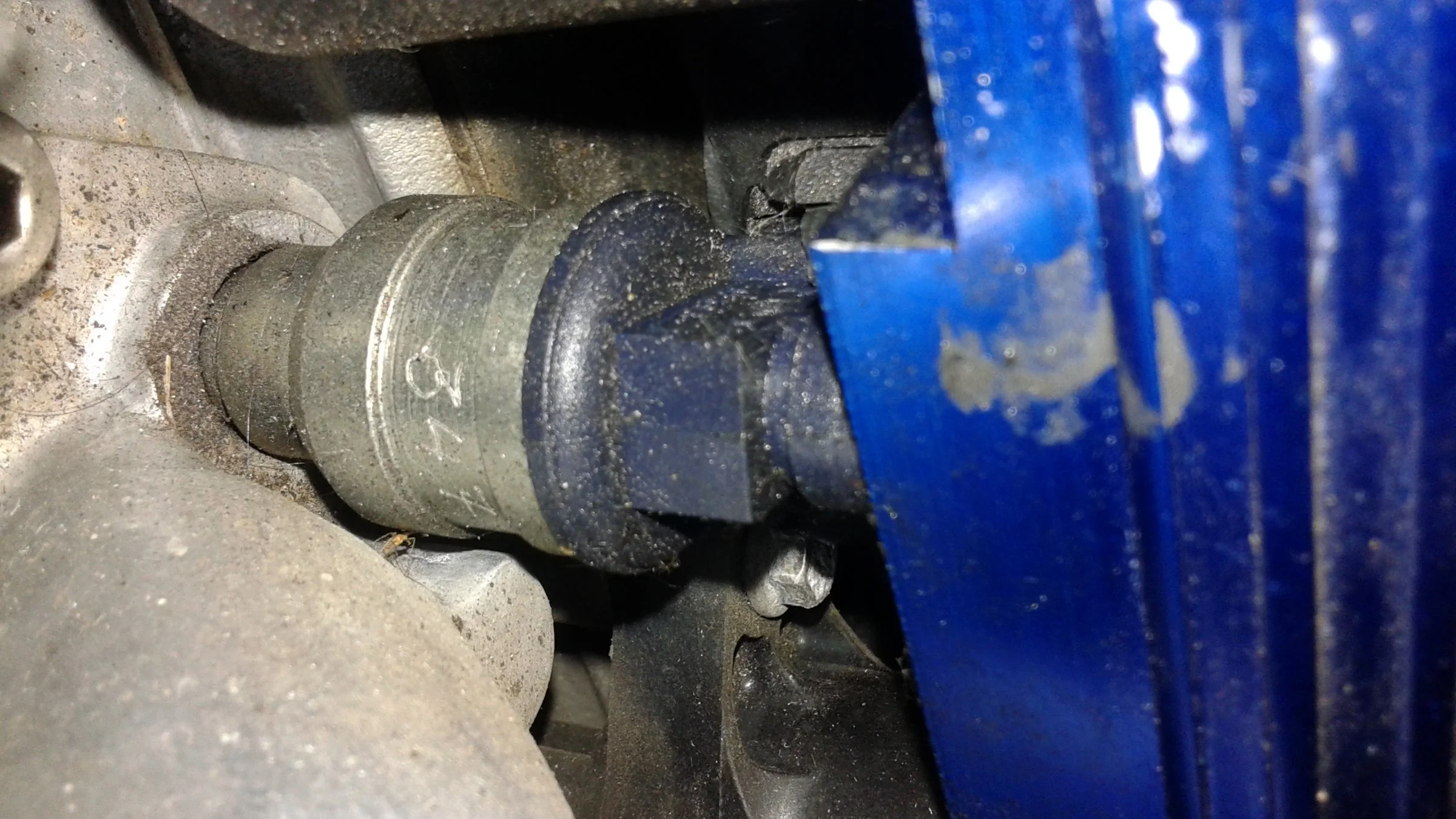

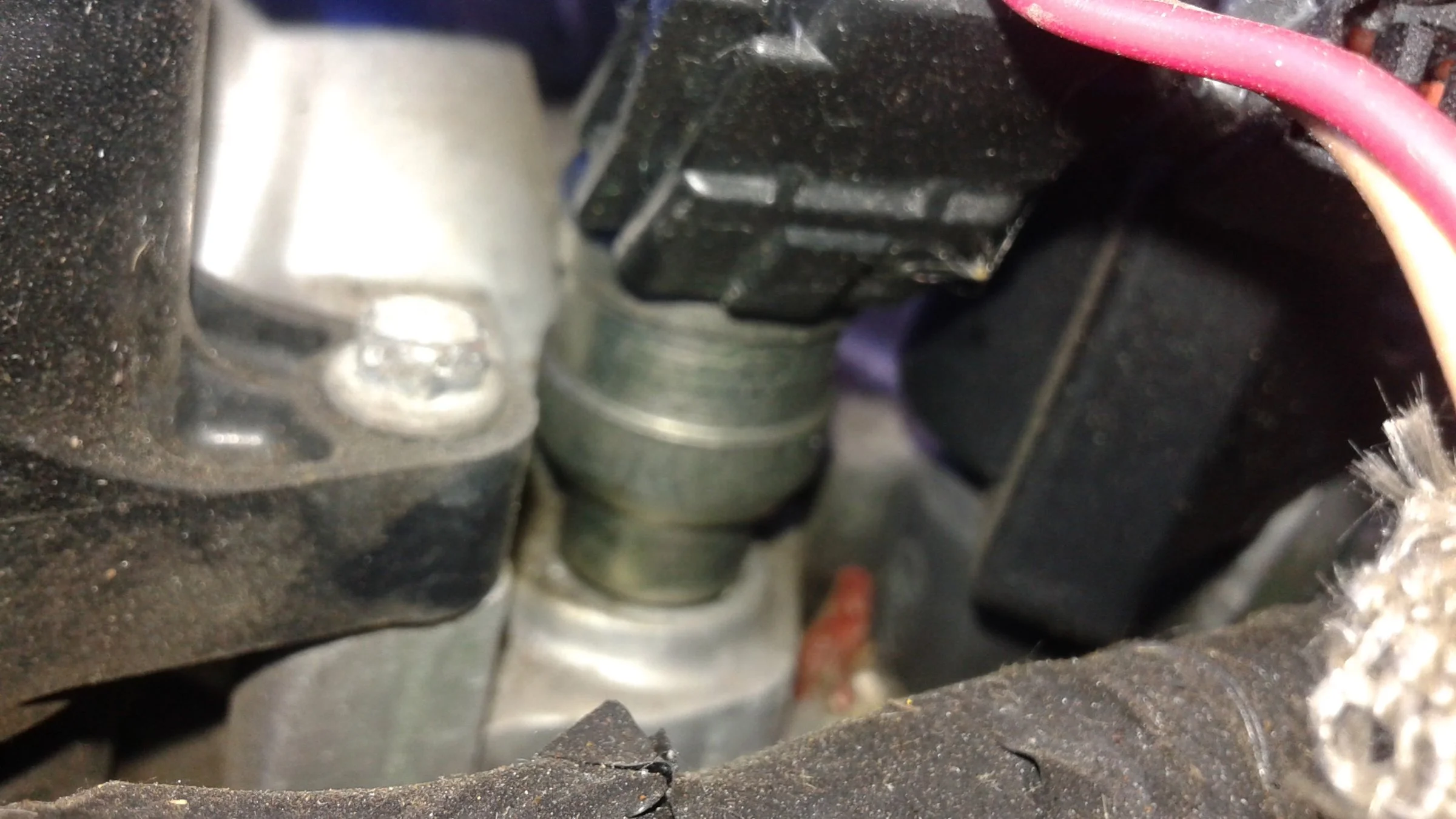

The injectors on the passenger side look duty compared to the ones on the driver side.

I was hoping I'd see a different color other than black. Usually, the injectors are color coded if they are ford Motorsport. There are a lot of black aftermarket injectors of various sizes. Only way to find out is to get it tuned.

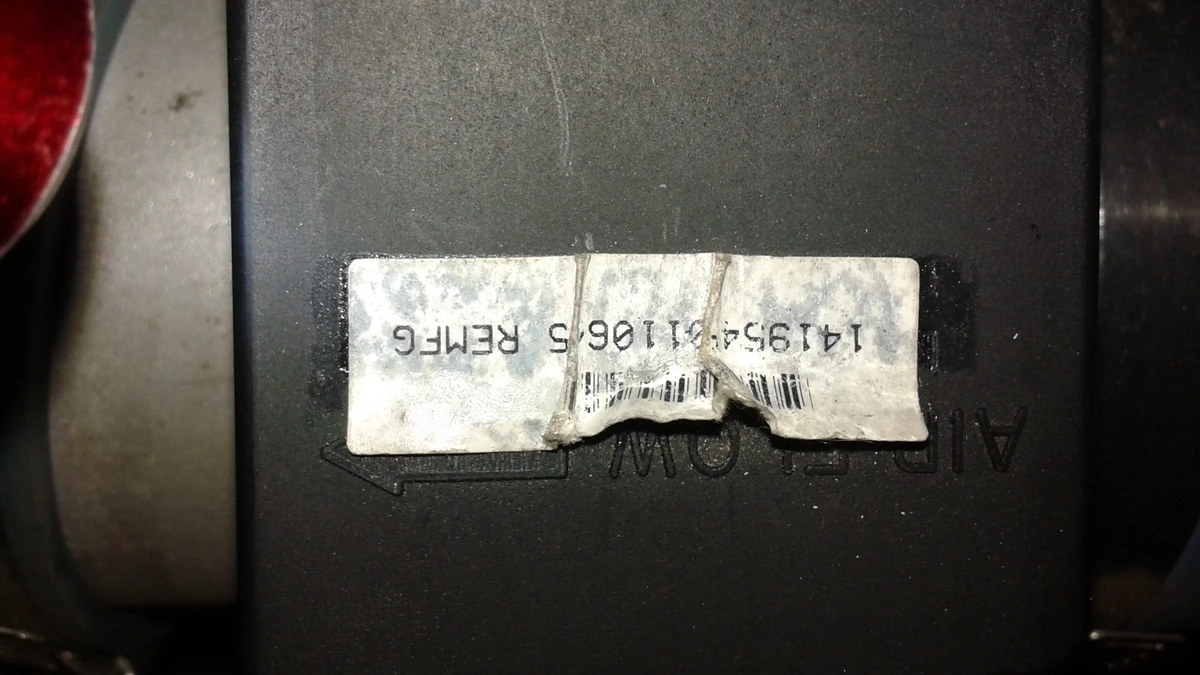

List part number of injectors, MAF, and EEC

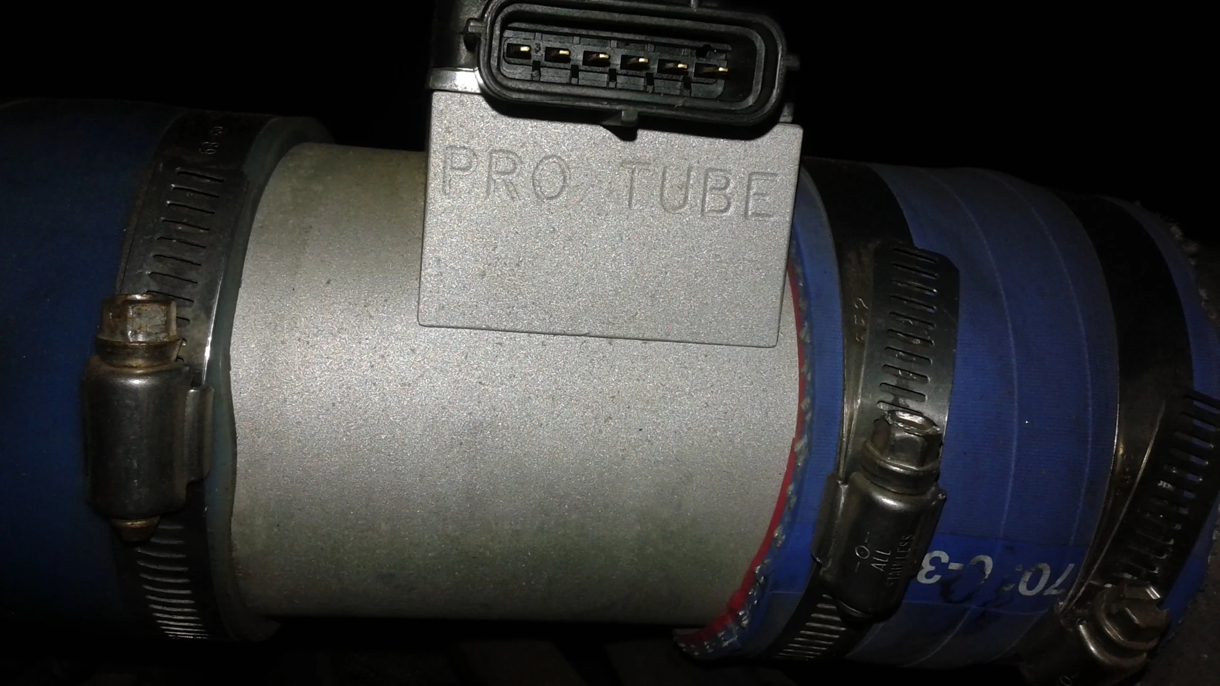

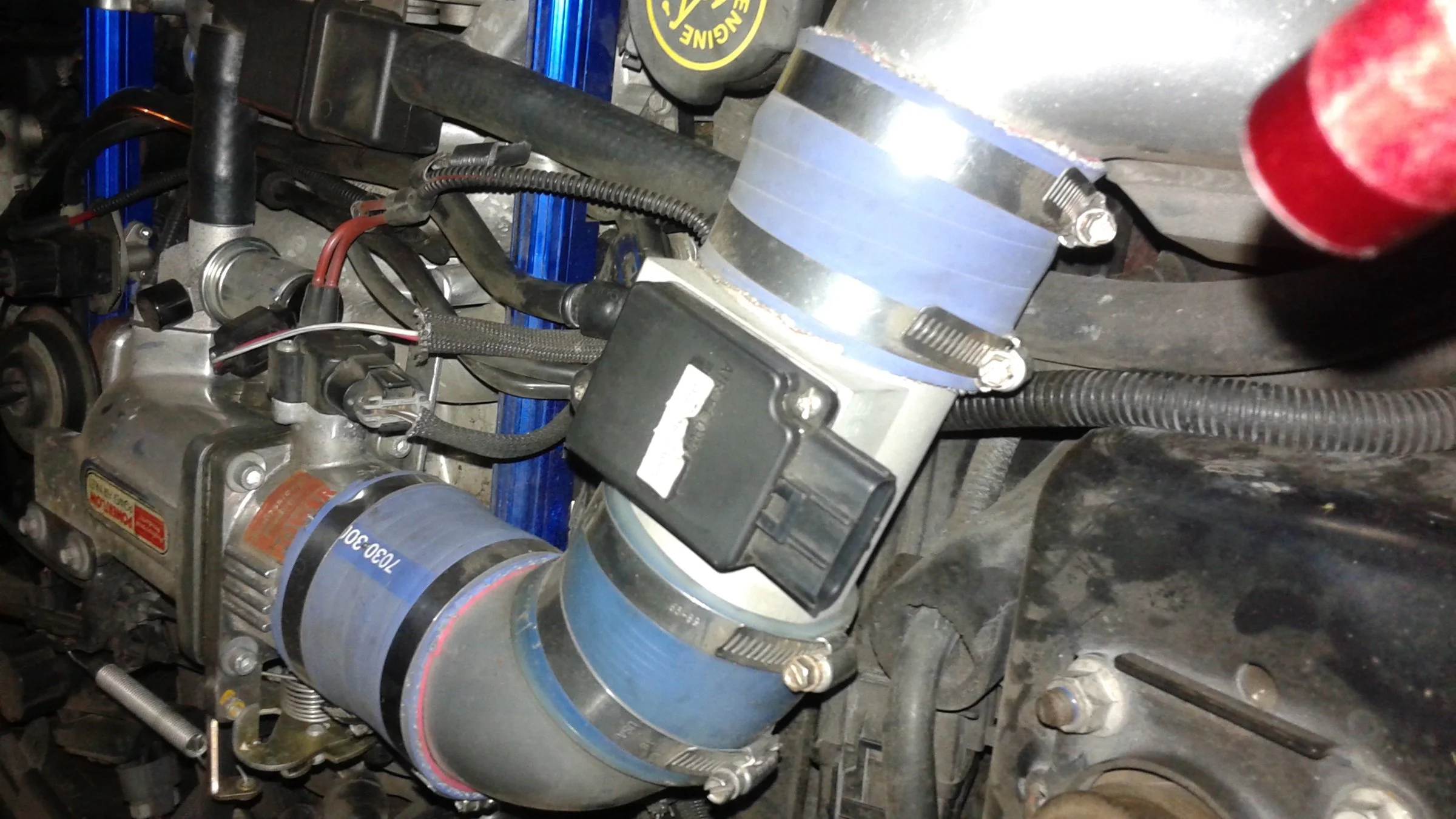

I think this is the MAF but I'm not sure. Whatever it is idk why it's not plugged into anything?

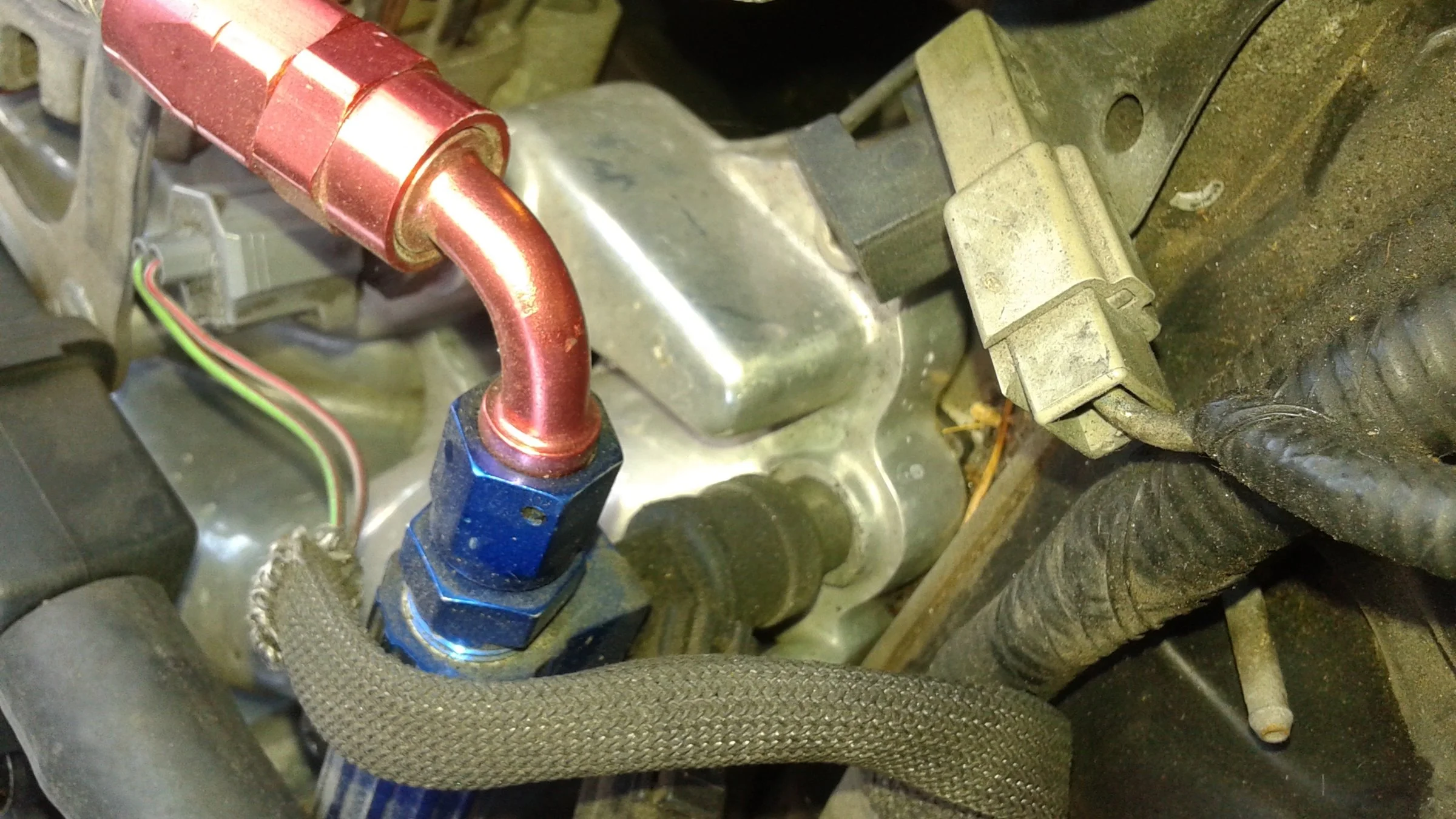

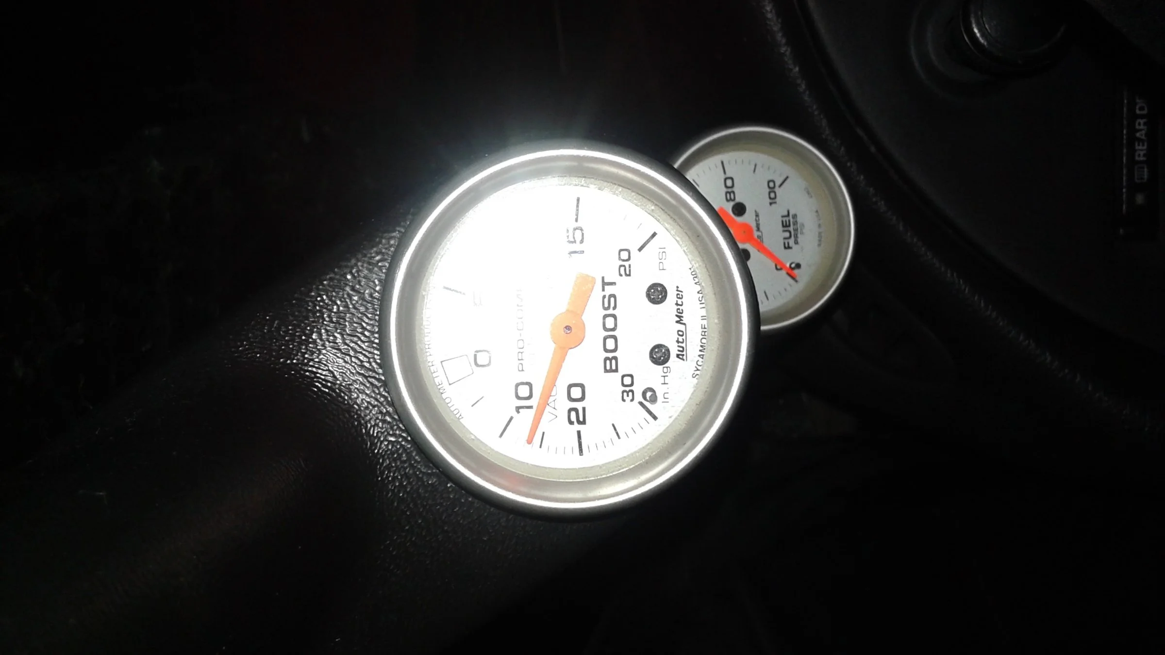

The injector says 347 on it other injectors have different numbers. I think they are 30lbs made by vortech. I could'nt figure out where my EEC part number was. I'm not sure if it is after Cooled here is a pic of my set up. By the looks of the boost gage it is saying 20lbs of boost.
