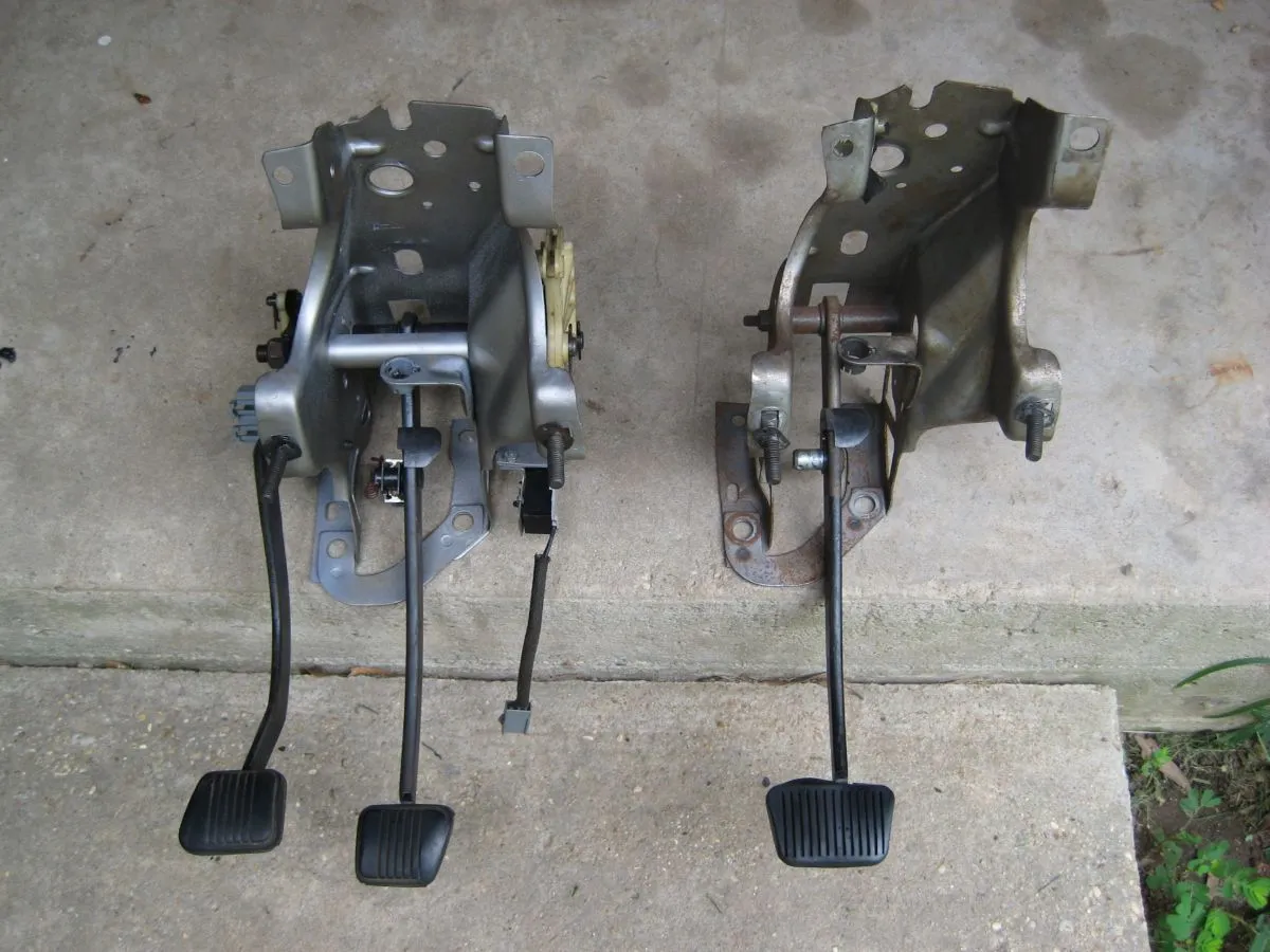

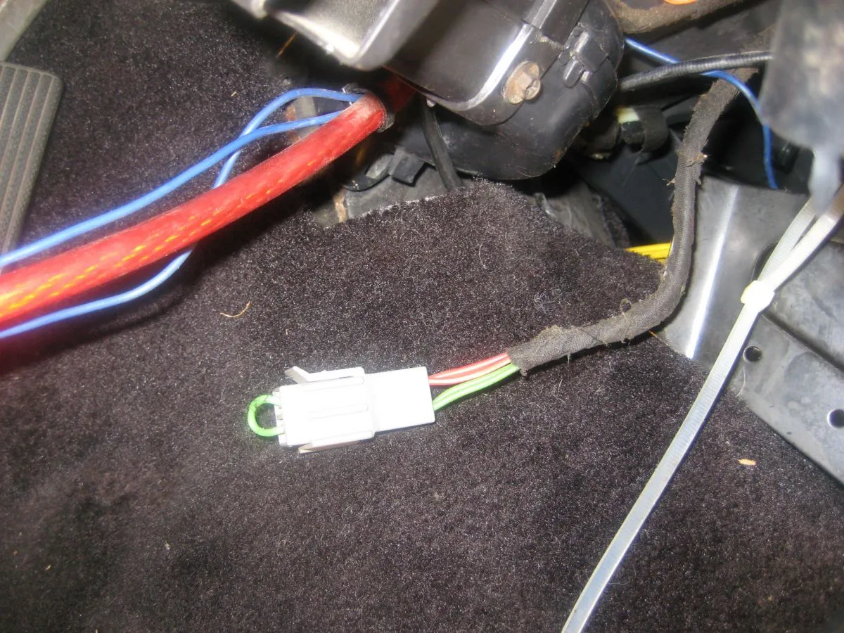

Can anyone ID what plug is hanging on the first pic (where gas pedal would be) and what its function is, and where it plugs into? Im trying to work out a wiring issue from an AOD to Manual swap, in which case the PO did not replace the AOD harness with the manual harness.
Cruise control shut off. Will turn off CC when clutch is pushed in. Should also be a vacuum dump on the brake pedal.
What sort of wiring issues are you chasing? Other than adding the reverse harness and connecting the starter circuit and NGS plug to th clutch switch, there's no need to change out any of the AOD wiring unless you change to a manual computer. My cars been running great on AOD wiring for 10 years since my 5spd swap
