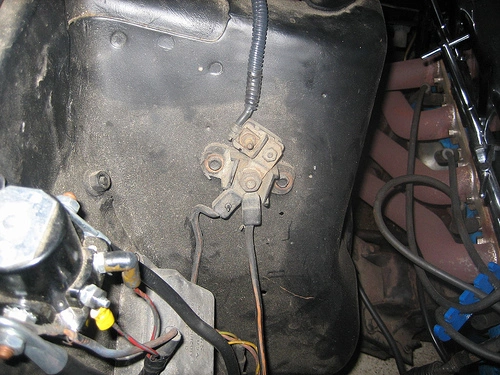

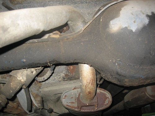

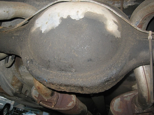

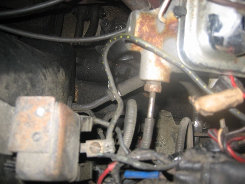

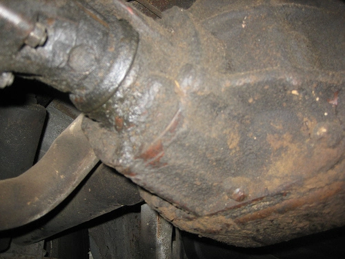

I've got two mystery parts and an unknown rearend in my '72 Mach 1 (302). Can you tell me what the two parts are and what they do and also what size rearend I have?
HIGH RES PICTURES HERE.
What is this in the lower left???
How about this thing?
Finally the rearend

First looks like a 12V relay commonly used for aftermarket lights. (i.e. fog lights)
should be four or five terminals on the bottom of it. Two of them would be the coil, one common for the contacts, one NO and one NC contact.
The other looks like a electrical junction point lots of mid to late 80's Fords used them as a positive junction point.
