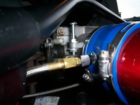

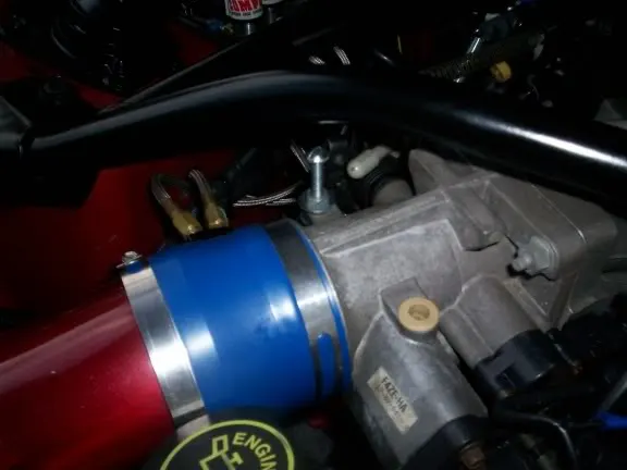

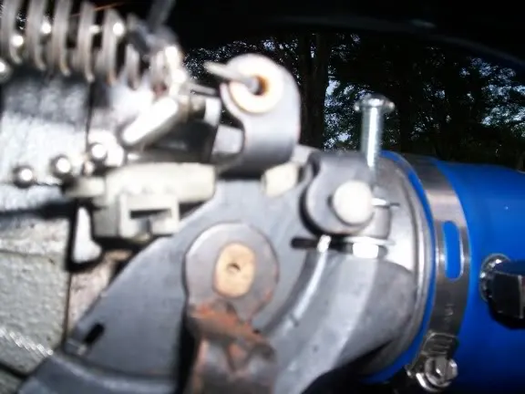

you can lightly tap the idle set screw on top with a hammer until it comes out thru bottom its pressed in but its easy to remove and go to the hardware store and buy a bolt and two nuts with washers and do as i did in the pics. below...

Yeah I used to but i can't recall it. I replaced the bolt after I started keeping a list of bolt sizes for our cars. I just backed the bolt all the way out and took it to the hardware store. I do remember it being metric and fine thread, something around M6.
