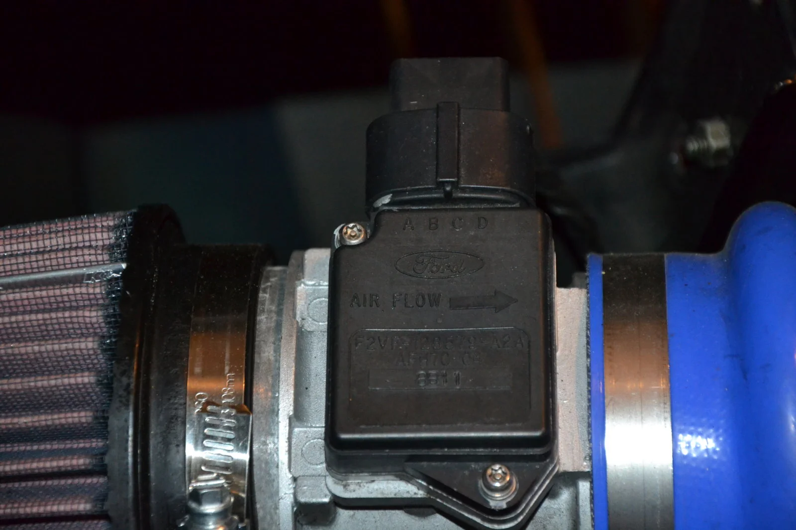

I corrected my idle serge and rich idle problems by cleaning the MAF sensor.It didn't look dirty ,But it had a very slight film on the elements,(almost invisible film).
Removed the sensor from the car. Hit it with Several liberal shots of CRC Mass Air Flow Sensor Cleaner.Let it completely dry for 1/2 hr....Reinstalled ....and problem solved :)
I Sprayed it away from the cars 'paint job'. Also the last couple shots of cleaner were applied following the MAFs airflow direction.
I'm thinking these K&N air filters(that are coated with oil from the factory) is the source of the film on the MAF elements.
Also, except for the "supercharger" I have the same exact set up as you....Just on a different BODY !:)!
