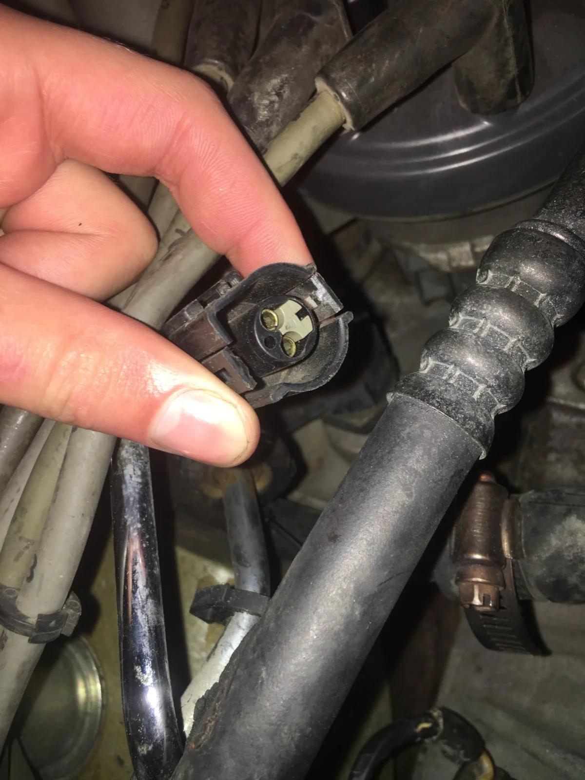

Just sent him the list. I’ll bug the hell out of him until we run through it, or I’ll do it myself. But now that that’s aside, I have 1 more problem. What the heck is this sensor? Cant find where it plugs in, but it was plugged in before we pulled the engine! Thanks for your help by the way!!

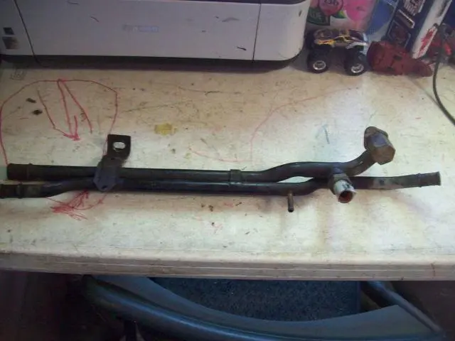

That's the ECT (Engine Coolant Temperature) sensor. It tells the computer what temperature the engine is running at. The computer uses this information to set the spark advance and air/fuel mixture ratio,
There are two similar connectors in that area, one is for the sensor on the heater tube, the other is for the charcoal canister purge valve.
i think
i'll look in a few
Yup, only two there. The wiring for the purge valve has a pig tail from that connector to the valve down by canister along with the vacuum line.

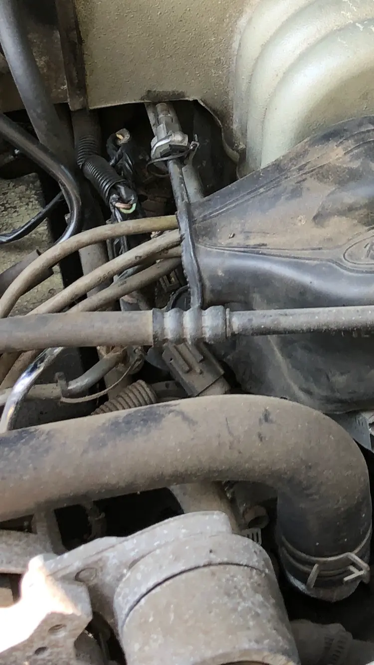

Is there any chance you can take a picture/video showing where it goes? We have to find the other end.
I can describe it faster, below the air box is a plastic box with what looks like a mushroom on top, there is a plastic line that runs down the frame rail from the fuel tank that connects to the tank on one end and the purge valve is connected to another nipple with a vacuum line and the wiring pigtail up by the fuel lines on the block to connect the pigtail to that connector and the vacuum line to the front of the intake.
Confused yet? Google fox purge valve and you will see pics
I did some research, and that switch is way back in the engine near the firewall, this plug is right next to the distributor. I know you know wayyy more than me, but that doesn’t seem right?
You are indeed correct. I have edited my post to correct the error, thanks for the heads up.
If that is the coolant temp sensor plug, the sensor is on the black metal coolant tubes that go to the back of the engine and into the firewall to the heater core. I have had a bad coolant temp sensor cause high idle on startup. Find the sensor and lug it in. It could be your problem.

Ya, it was the purge valve. We bought some vacuum to run it from the intake, to the sensor, and onto the charcoal canister. And the reason I couldn't find the other end is because the 5.0 canister was still on the donor car! Little errors lol. I dont think its 100% the idle problem, but I'm sure it'll solve the gas fumes, and maybe bring it down a little bit. We also messed with timing which helped a lot. Running through the checklist after we hook up the charcoal vacuum.
