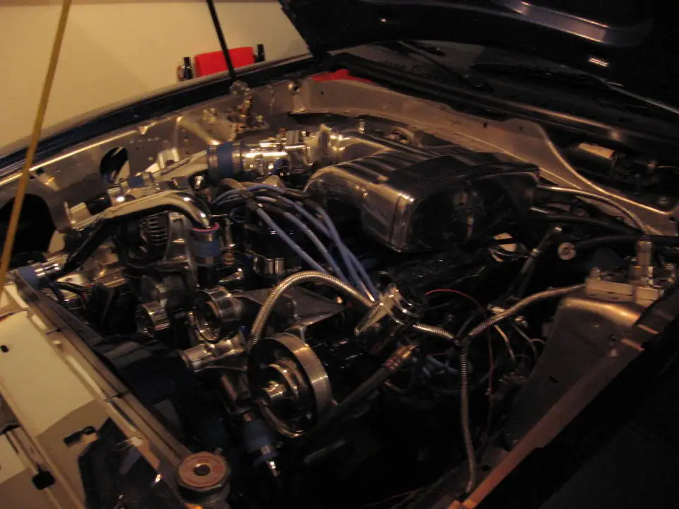

Oh and here's a small sample of what I've been doing all winter...Just waiting on my new hood, coil, and firewall cover to come back from paint and then I'll post a lot of pics.
