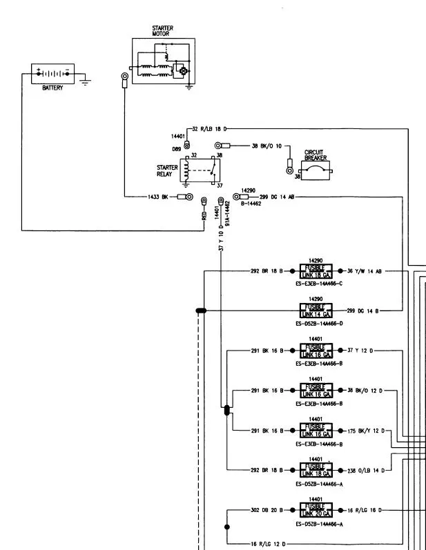

Roadblock Founding Member Jul 13, 2002 208 0 0 VA May 26, 2005 #1 May 26, 2005 #1 View attachment 513509 i wanna move it to the passenger side of the car, what does that relay thing do ?
S ss93cobra Founding Member Apr 10, 2002 1,422 1 0 Wilmington NC May 26, 2005 #2 May 26, 2005 #2 circuit breaker for power window and perhaps power locks as well.
Roadblock Founding Member Jul 13, 2002 208 0 0 VA May 26, 2005 #3 May 26, 2005 #3 i think it's the PCM power source hence the breaker
Stang8URMPRT Active Member Dec 28, 2003 1,100 1 38 Daytona Beach, FL May 27, 2005 #5 May 27, 2005 #5 Nothing you show there is an ignition switch.
jrichker StangNet's favorite TOOL In Remembrance. Thank you for your contributions Mar 10, 2000 27,512 2,813 234 Dublin GA May 27, 2005 #6 May 27, 2005 #6 ss93cobra said: circuit breaker for power window and perhaps power locks as well. Click to expand... Agreed. The computer uses a fuse link buried inside the wiring harness near the starter solenoid. Attachments starter solenoid wiring.webp 23.9 KB · Views: 392
