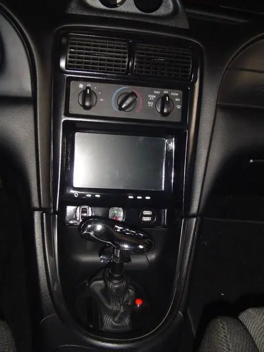

heres a quick pic of the screen installed. its a bad pick with my old camera because my good camera is packed away for my trip.
theres a on/off/auto switch on the bottom left, led indicators in the middle, and 2 usb ports (thumb drive and the other for a mini flex keyboard). i still have to do some finishing touches on the bezel but for now im happy.

That's pretty slick, Dan. One of the best LCD installs I've seen in a 'stang.
I'm about to start my own CarPC install, so I'm curious, what did you use to make your dash? Fiberglass? Plastic filler of some sort? What did you use to handle the on/off? Did you start with your dash, or snag one from a 96+ (with the double din)?
How are the temps behind the LCD? I'm considering adding a small (CPU sized) fan with some venting for my install, since it get so hot back there with just the radio/HVAC when the heat is running.

The double din radios didnt come until 1999 or 2000. Thats the easiest place to start. Check out mp3car.com for lots of help and ideas. Guys are using a M2 ATX DC to DC Power Supply Unit that senses when you turn the ignition on and off and can handle the shut down/hibernate sequences.
