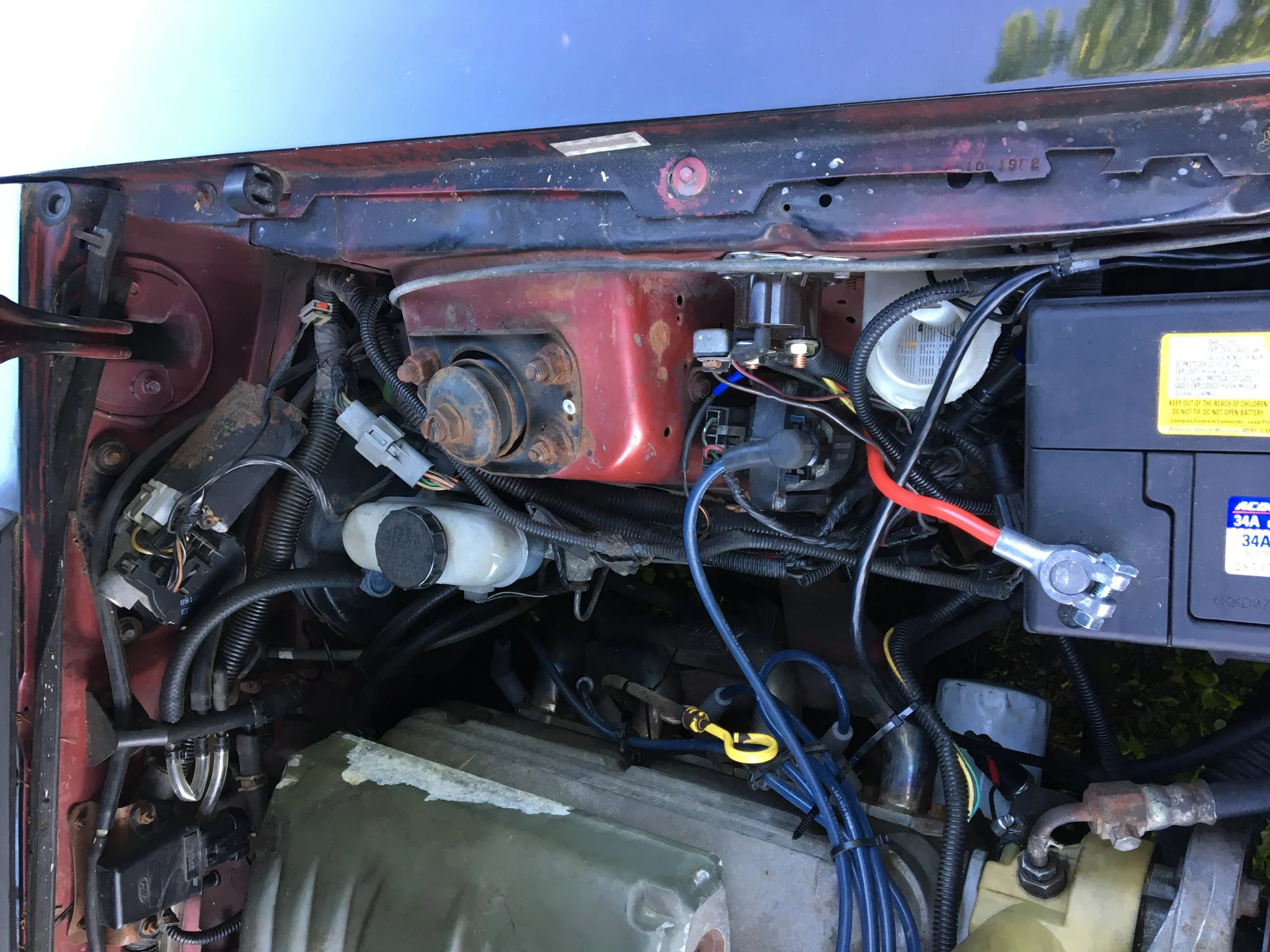

Charging issue: I've replaced the battery cables and solenoid.
I tested the battery and it's low.
The alternator was tested as a 5 out of 6 on my meter.

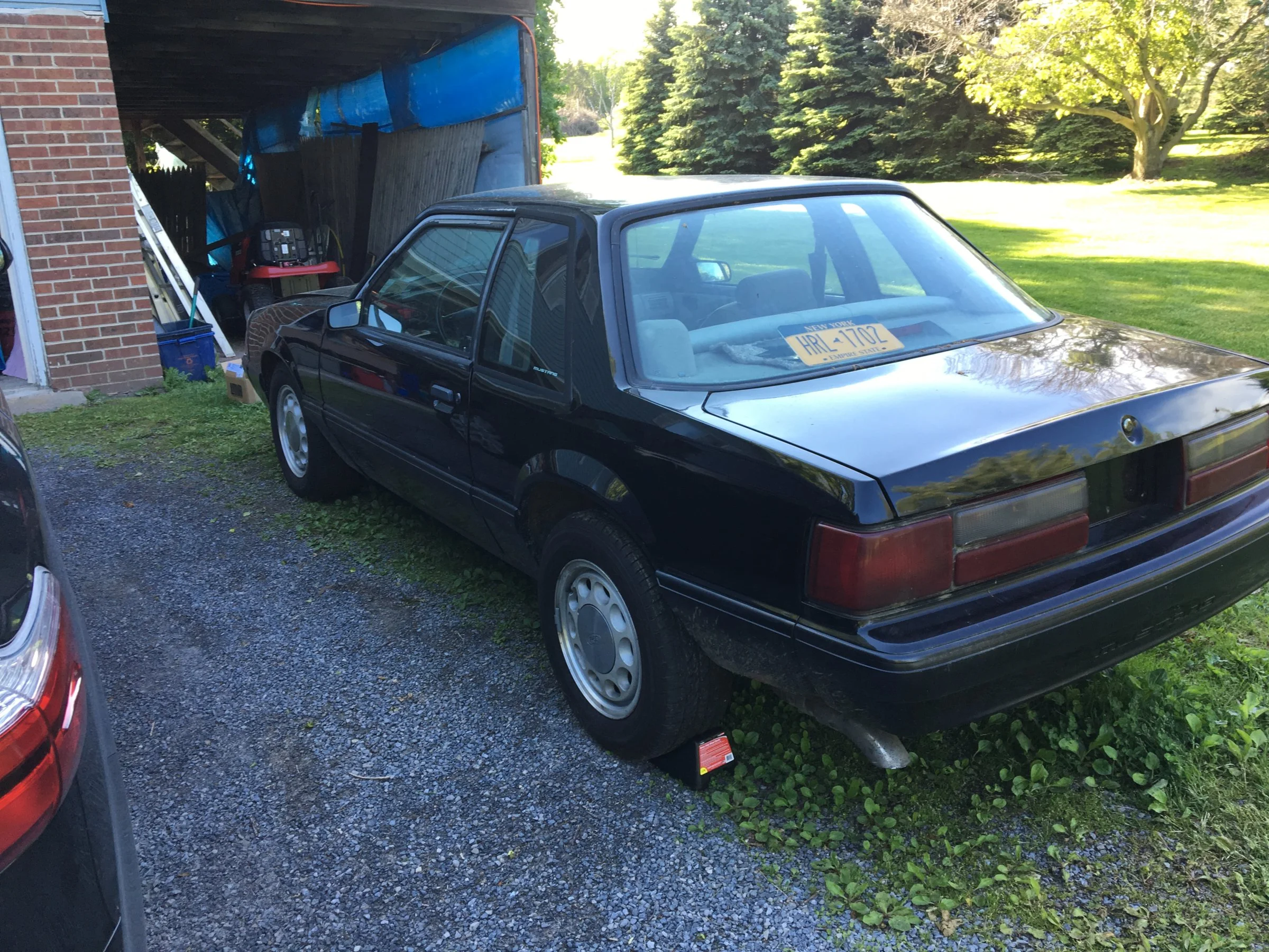

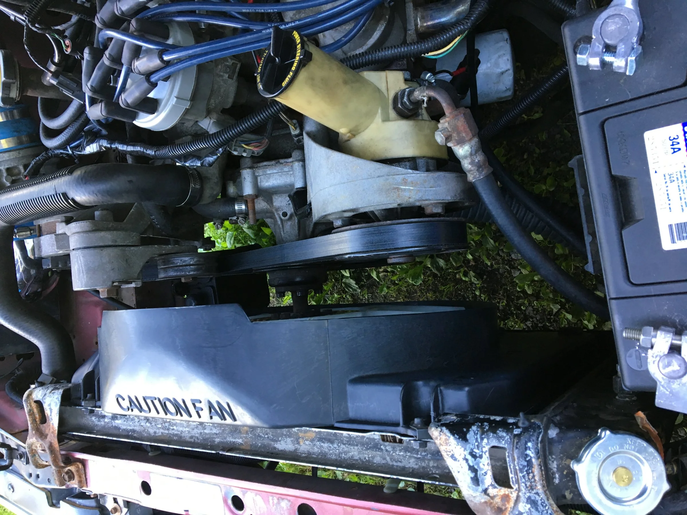

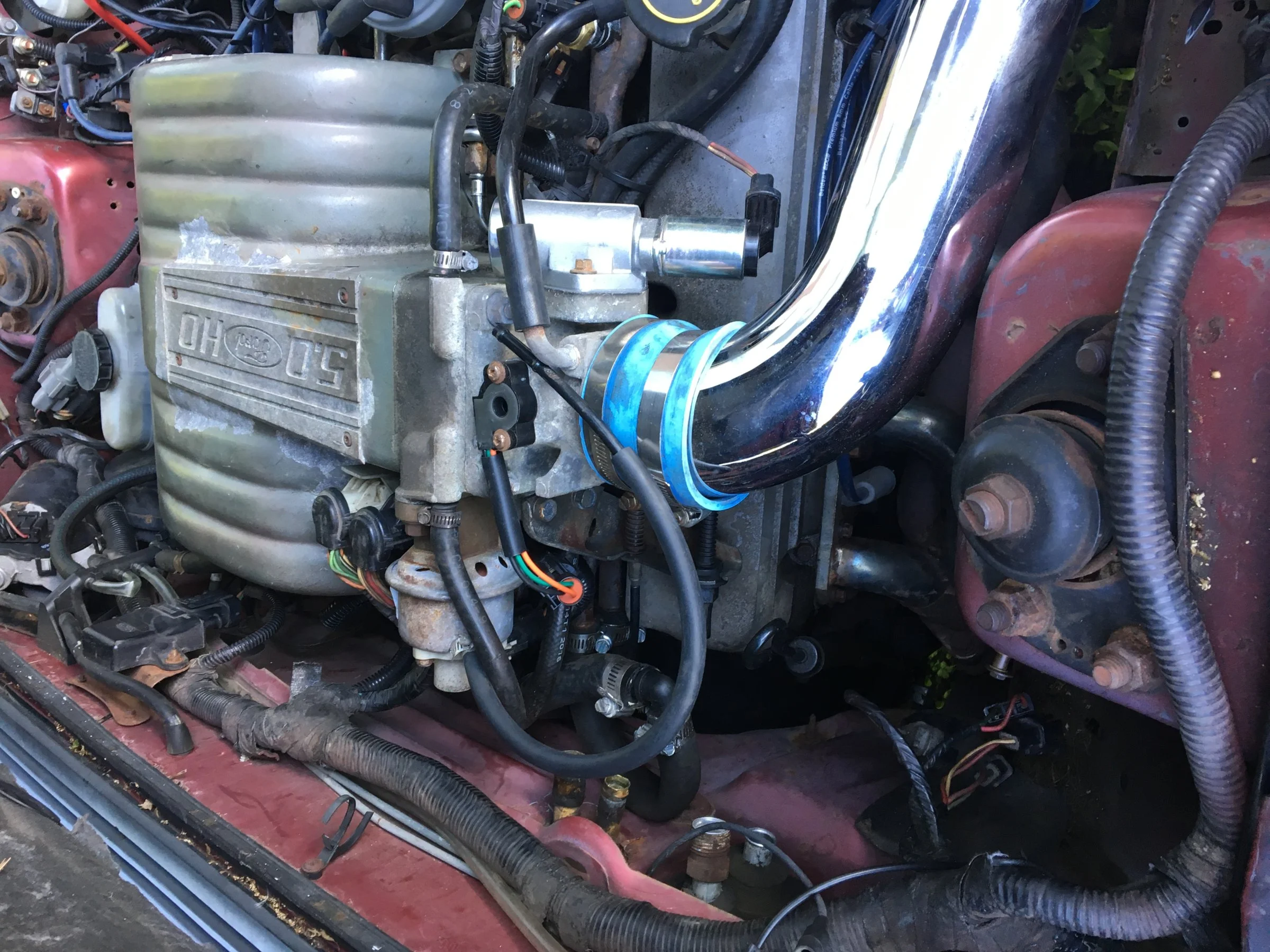

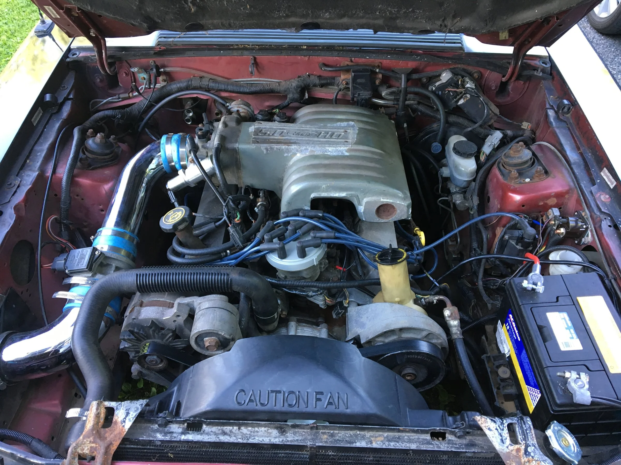

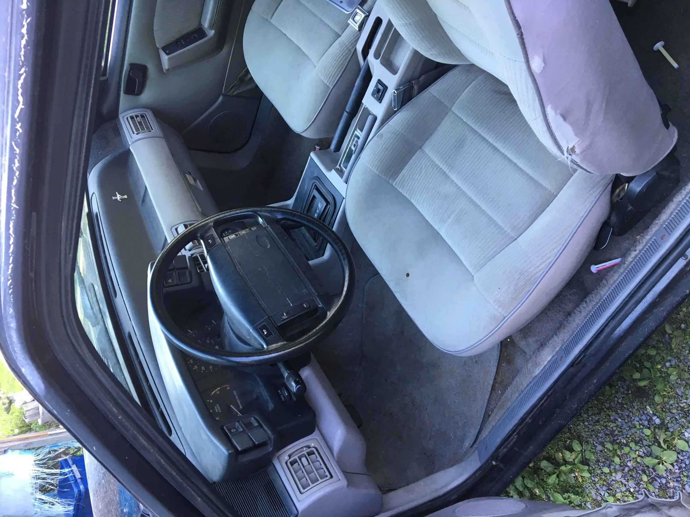

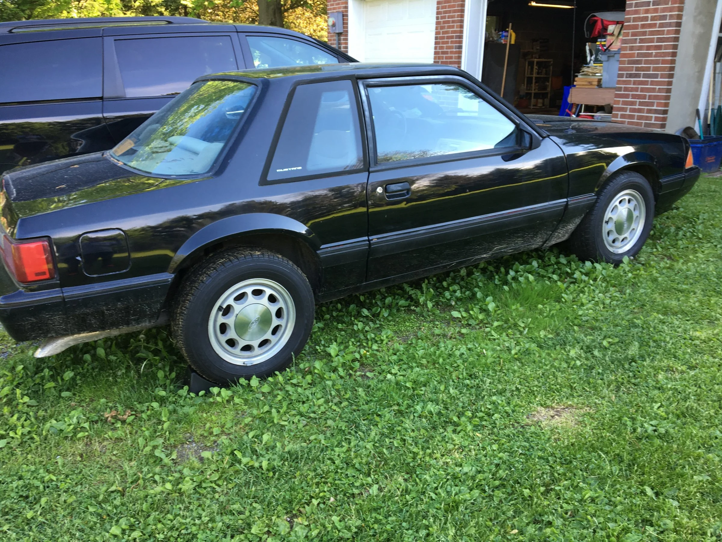

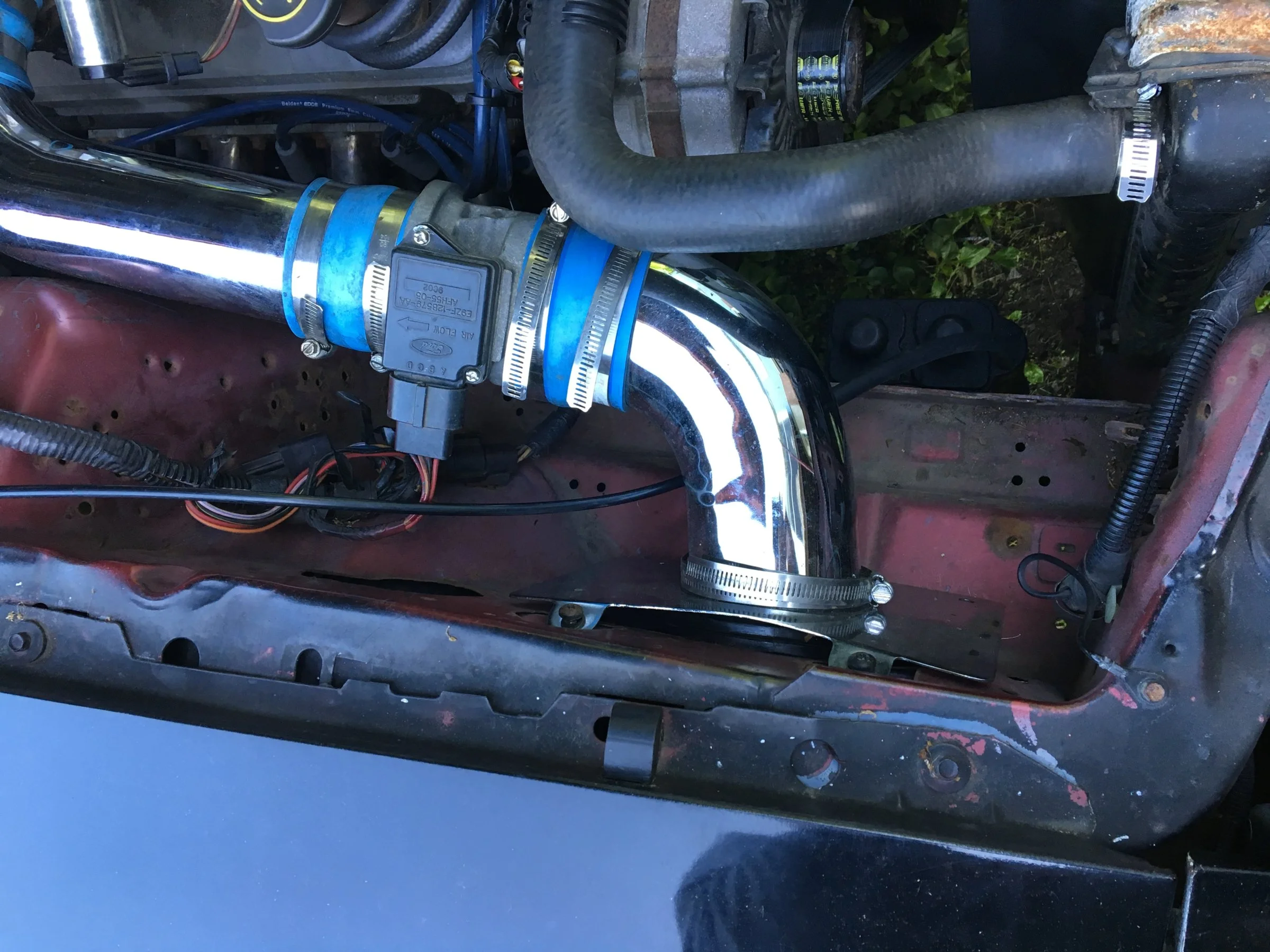

Here are some pics.
Reactions: Noobz347
That car is a 5 out of 10 in my opinion, looks like a good save.
Keep us posted.
Thanks!
It definitely needs some TLC.
The car only has 41k on it.
If sat for a few years after the original 4cyl owner got a DWI.
I'm hoping to get it done in a similar fashion as the "nasty notch" was done.
