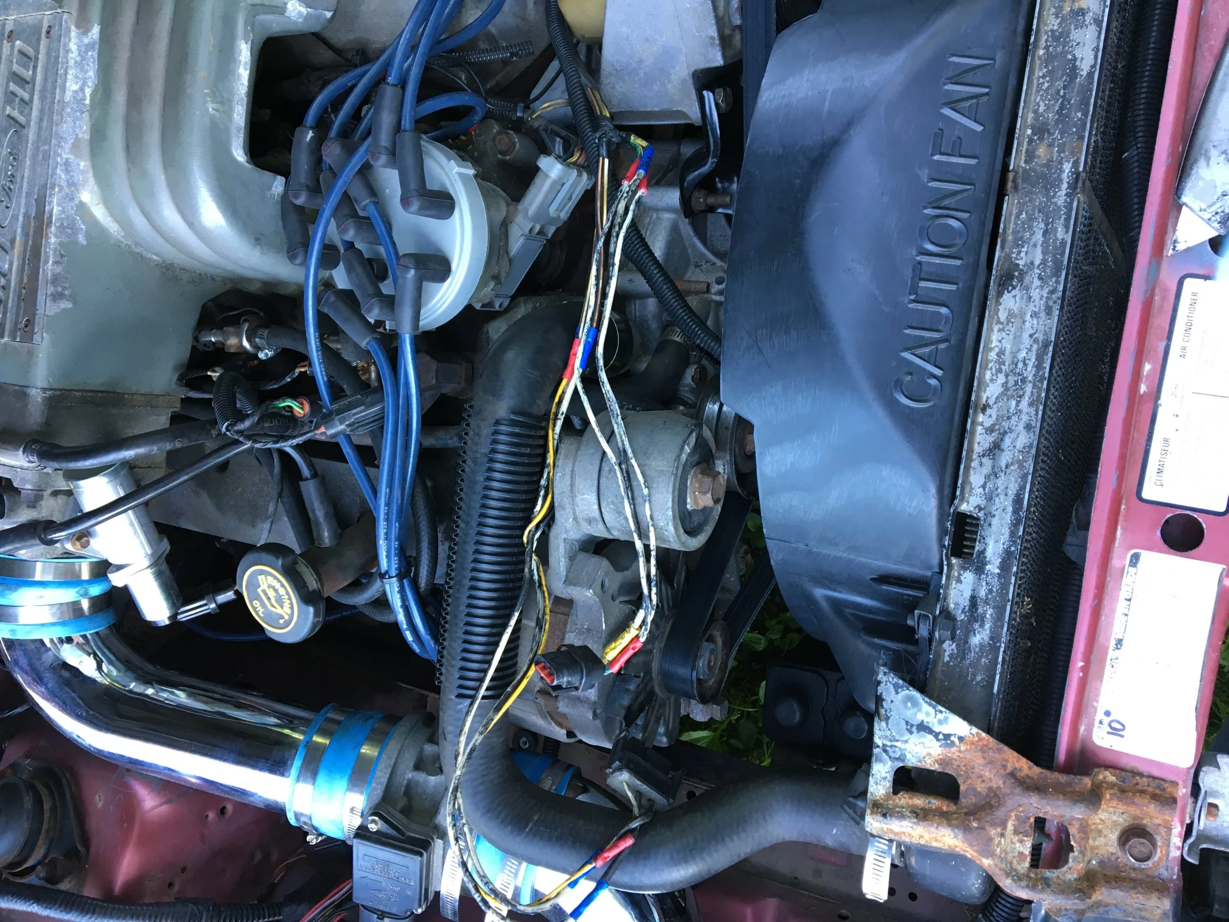

The alternator looks original and could be the issue behind charging problems.

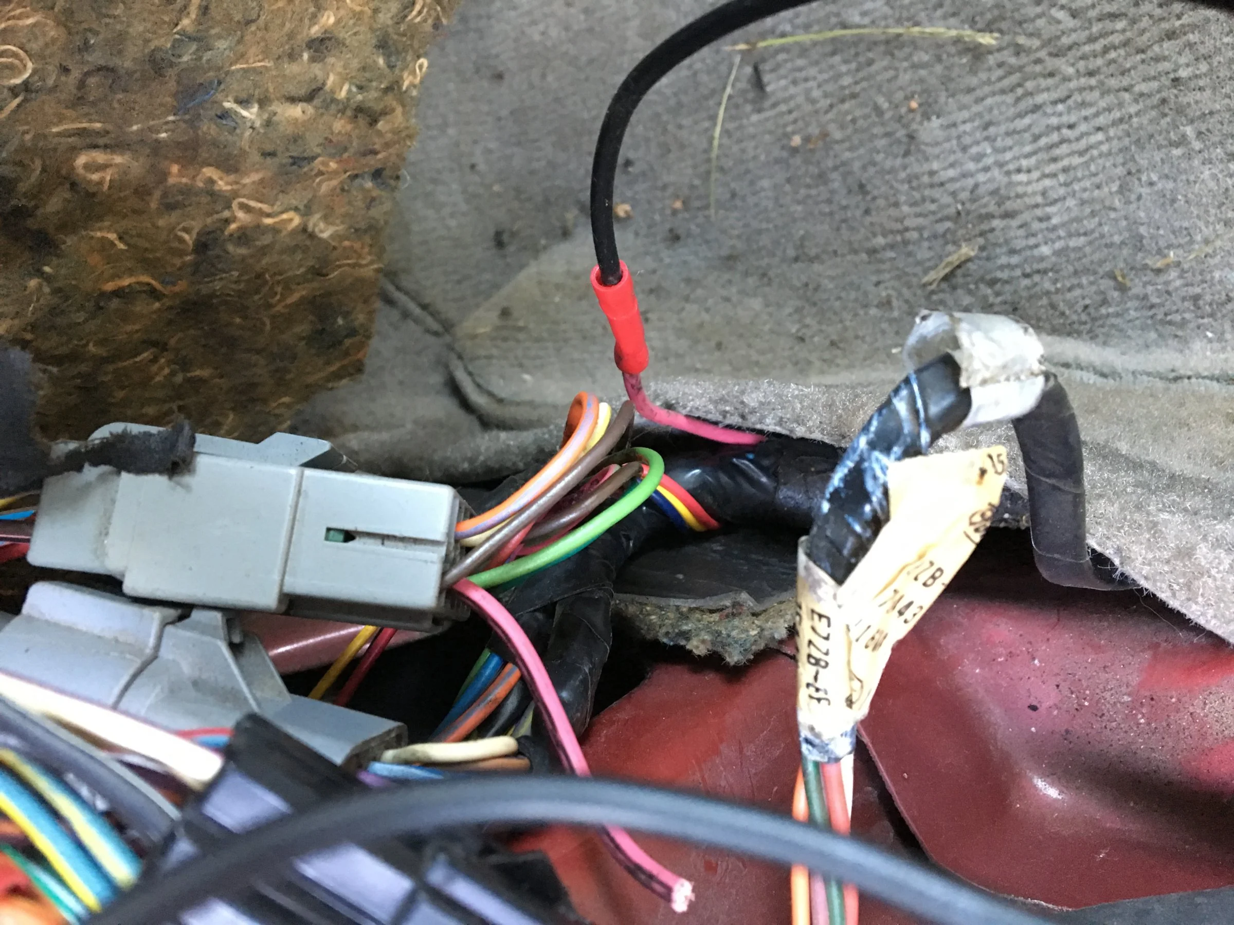

Plus, the butt crimps could not be done correctly, so I will change all of those to soldered lines and replace the alternator with a 130-150.
