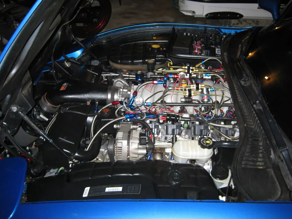

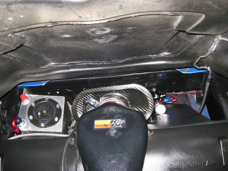

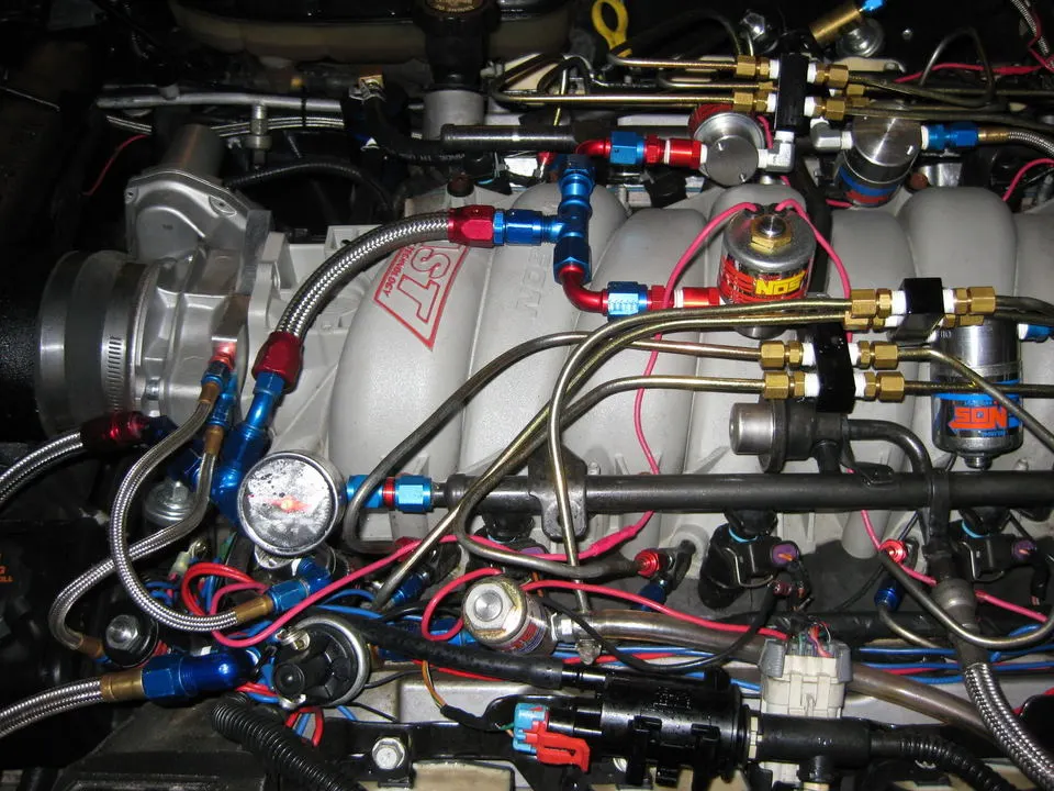

These pics are out of the previous owners photo album. I haven't taken any pics of my own yet.:nice:

I tell ya though, if that beast were mine and it really is a streettoy then I would yank that entire nitrous setup off that thing and sell it. It looks like a good grand worth of stuff. Then I would get an ATI twin intercooled Procharger on it. If its all forged internals then you could throw 12 psi at it VERY SAFTLY and make 750 ish rwhp on pump gas and around 830 on race fuel... maybe more. :nice:

you know what, I would love to put a blower on this car. I had a preliminary conversation with my tuner about doing exactly that to this car and he said he didn't think it would be a very good idea. He talked directly with the previous owner and knows more about this than I do. But he commented that the car has a low compression engine specifically designed to run the nitrous on the car.
I don't know much about nitrous but I'm guessing they like low compression? I will text the other owner and ask him what the compression is on the engine and post up in a few hours when I get home from dinner. Going to Chili's, 2 for $20...how can that be beat :nice: my lady is easy to please:D

I talked to him to today and he said 10.5-1 which is dead on for a blower right? or does the ideal compression ratio vary from one engine to another?

And as cobra red said, nitrous loves compression. Now 10.5 is a hair on the high side for a blower but with a nice tune and forged internals you could throw 9 psi at it all day long and be very very safe. The 9 psi hit would give you about 700-730 rwhp and the nice thing is the car will drive exactly how it does now when not under boost and will kick harder under boost then it did with the nitrous AND you dont have only 40 seconds of fun before you have to refill it. Plus you have some trunk room again. :nice:
BTW: Meth dont make a bug difference with Nitrous but blowers LOVE meth injection. With that running as well then 750 is no problem. The car will be an absolute torque monstor! Should run mid 9's and be able to hit 220ish. :shock:

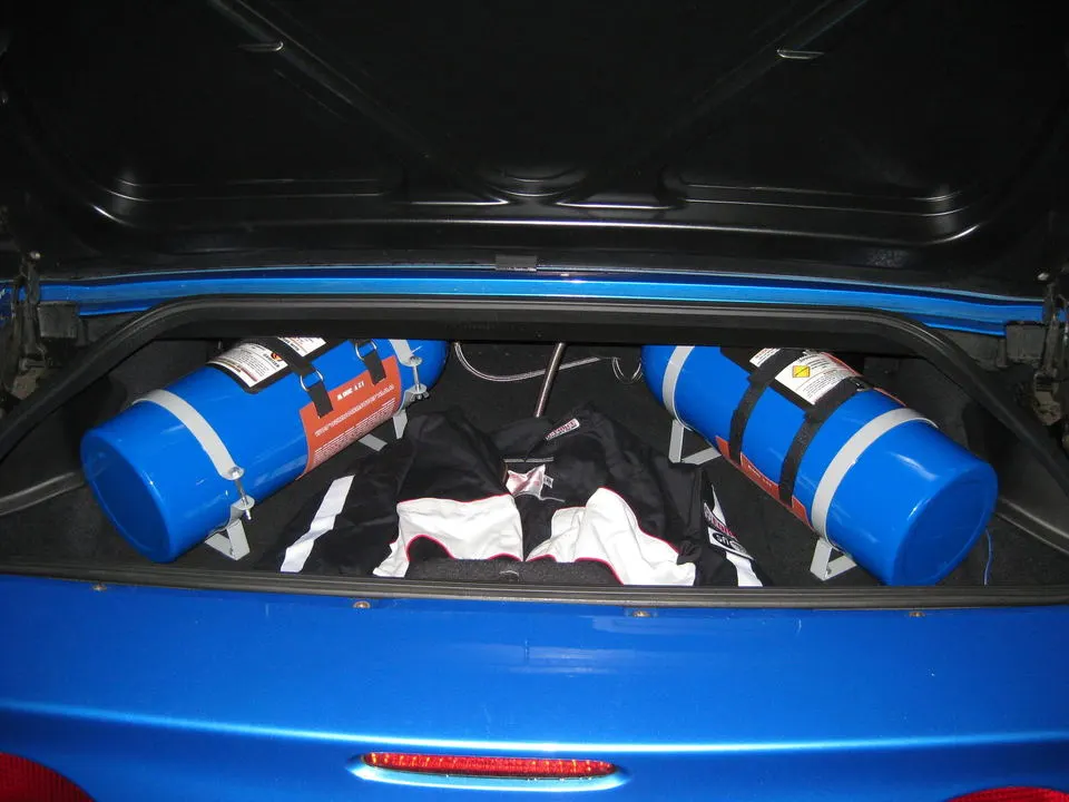

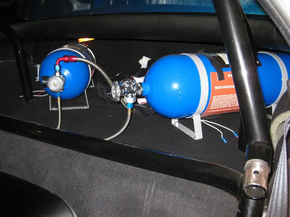

well there are two 20lb bottles of the stuff. :eek: have to figure that will last a little while eh?

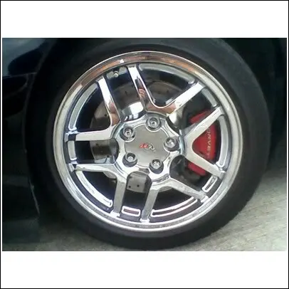

Ya, I'm not so sure on the brake front. They seem good right now. I will live with them for a little and see. I would have to upsize my rims to 18 from 17 in the front and 19 from 18 in the rear. I was thinking decreasing the sidewall of the tire definately wouldn't be helping with traction. We'll see.....but man that z06 stuff is nice.

With that shot size you will be empty on the 5th run...maybe the sixth if its a warm night and the bottles temp was kept warm.
Nitrous is excellent for the track but for the street you can have fun all the time with a blower. :nice:
And the Corvetts stock brakes are excellent but if you go road course racing you will need something better to maximize that cars power. Also if you get that thing up to redline in 4th and then to stop quickly you will feel a noticeable shimmy as the car drops below 60 mph because the rotor overheated.
Braided lines and drilled rotors actually help out quite a bit with the stock calipers and are pretty cheap.

the car already has either brembo or baer rotors with hawk pads. can't remember which he told me.

The hawk pads are great pads. I just put in cross drilled/slotted rotors on my car, with hawk pads. Light years above the stock setup. Tonight, I tested them out from 30mph, 40mph, and 60mph. I thought my eyeballs were being sucked out.
Drilled rotors have been known to crack in severe racing conditions which is why on a track car you should use slotted. Drilled is perfect for agressive street driving and occasional track usage.
