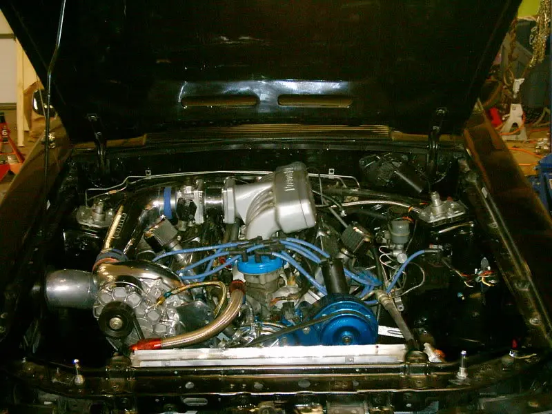

The other one i saw recently was a 347 SSC saleen, DFI, vortech YSi with a custom vortech aftercooler setup. Car made mid 700's to the wheels, on race gas. I say custom because i don't think the aftercooler was meant to be run on the ysi.
