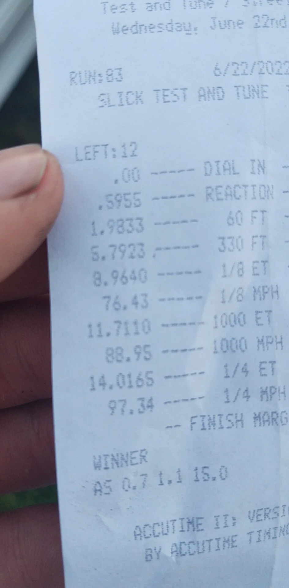

So the entire time I've owned my GT I've been stuck at 2.0X 60ft's, being able to get a few 1.9X's. My first attempt to remedy this was 255mm Toyo R888's, I still spun with just 260~ hp. Thought new shocks would help, put strange 10 way adjustables on it and the reccomended drag settings, still spinning. Still trying to chase down this issue, looking at springs and rear control arms. It is a 5 speed car with a stage 1 exedy clutch and still has the stock 3.08 gears. (the posi works it has fresh clutch packs)

Earlier this year in June when I ran it I think I took them to 20 at first, then took them down to 16 or 18 after that. Didn't really see much improvement. To launch the car I slip the clutch to get it to roll out and to keep the rpm up. After the car is rolling I try to get off the clutch as fast as possible to keep from burning it. The car spins when I am at like 1/2 way to the 60 ft bulb trying to get out of the clutch. I can't think of a better way to launch the car. I've tried getting out of the clutch sooner it either bogs down to 3000rpm or spins. My thought is too much wheelspeed from the 3.08 gear
