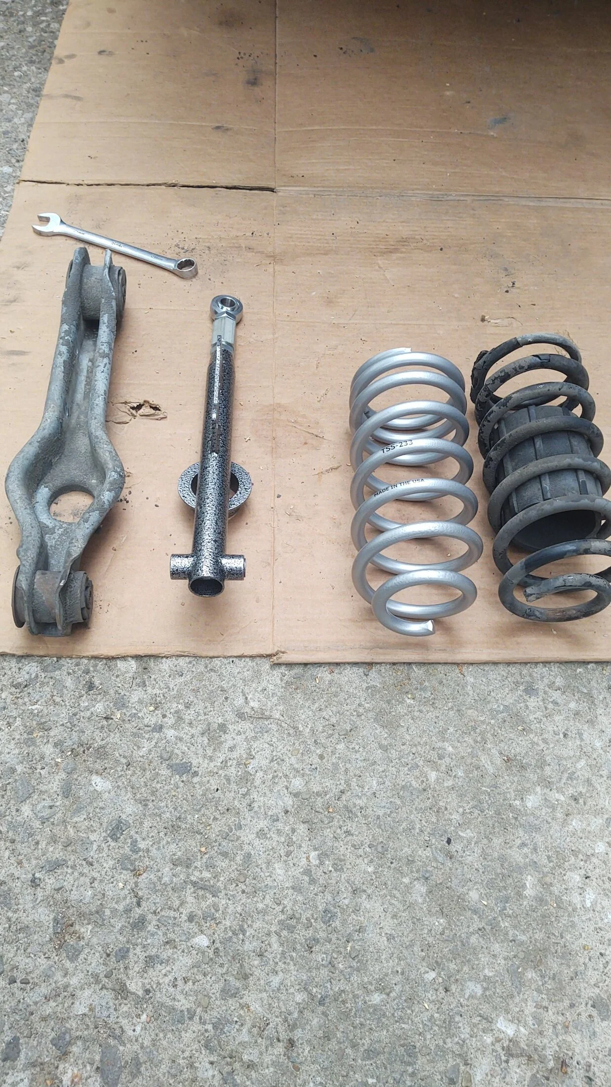

Hey everyone! And for anyone else that stumbles across this thread. The car is finally in the 13s! As I said earlier in the thread, doing a gear swap was not a real option for me due to lack of time and knowledge. So I followed your guys advise and did team Z/ BMR rear control arms, car is doing consistent 1.9X 60ft now with NO spinning at the track and is slightly better on the street. Also did some minor bolt ons and got a Dyno tune with a different tuner, car made 280whp 315tq on a dynojet, pretty pathetic I know. I'm finally biting the bullet on some 3.73s and having someone do it while I am away. If this gets the car in the 12's I will be blown away, also got my hands on some 4 lug draglites just in case it doesn't .

With 280/315 you're going to need a 1.7x sixty foot to drop into the twelves. Mount up a set of bias ply ET Streets on the Draglites, drop the air to 14# to start, launch at 4500-5000, and pick up your 12 second slip at the time shack.
I messed around for a season on first gen Nitto DR's and it was better than a street tire, but not good enough. I wish I had just stepped up to the bias ply ET Streets sooner.

The draglites already have 8 inch E.T drags on them but my T-5 and 8.8 are stock, my dad was worried about me blowing one of those out launching on a sticky tire but I will look into getting a c clip eliminator kit
