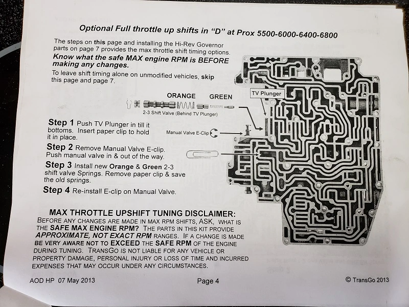

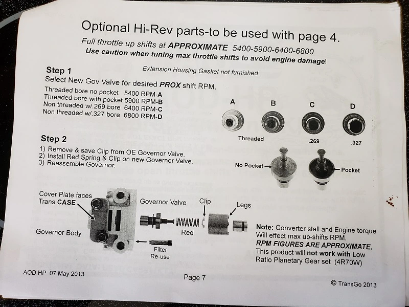

Found the instructions for the kit. Looks like you have to get into the valve body to do it.
For the governor
Related parts for the valve body.
Parts still sealed in the bag
It looks like all the parts needed are in the bag...4 governor valves, red spring, green spring, and orange spring.
Looks like the kit you found has the same parts in it. If you want it, e-mail me your address and I'll get it in the mail. I can also make copies of the instructions and send them too.
Dave
ETA: I got this kit for an AOD I built for my truck. I decided not to use the hi-rev part because I was going for low-end torque and wanted a little earlier shifts. Learned when stepping on it, it still shifts between 5500-6000.
