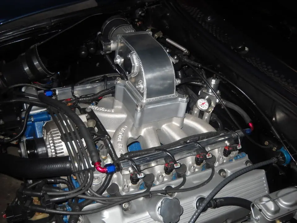

here is mine with the 3848 eddy plenum, its a monster!! plus you can use either a ls1 or 2 or 5.0 style throttle body.. i drilled and tapped my intake for the stock rails, and it works great. make sure you at least have a 3" cowl, i had to cut a hole in my hood for it to fit.. and make sure you move up the revlimiter up about 500 rpms, it will need it.. all in all i love mine, it makes assloads of power in the upper half..
[/IMG]

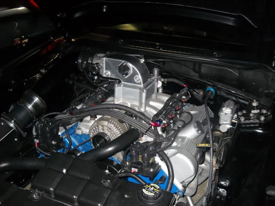

and a rail shot
[/IMG]
