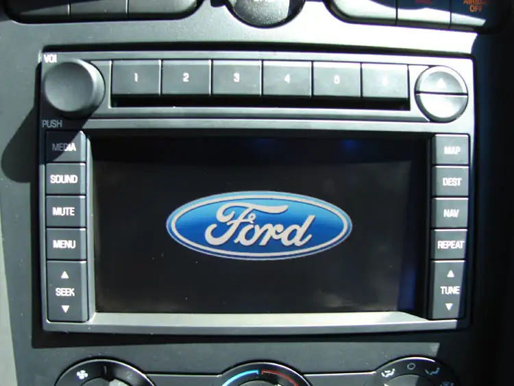

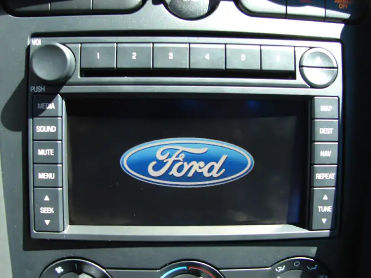

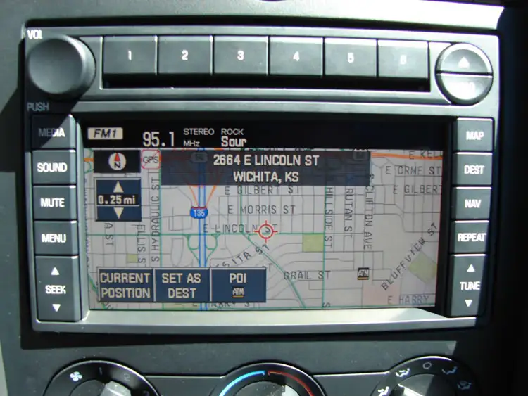

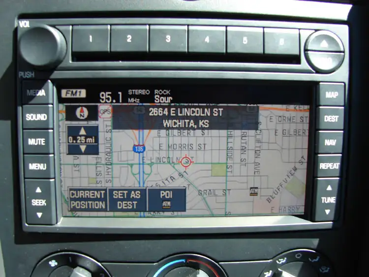

Well, it is installed. Just no GPS yet... which means the nav and map is off... But here are some pictures I just took of it...
