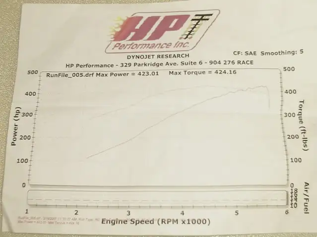

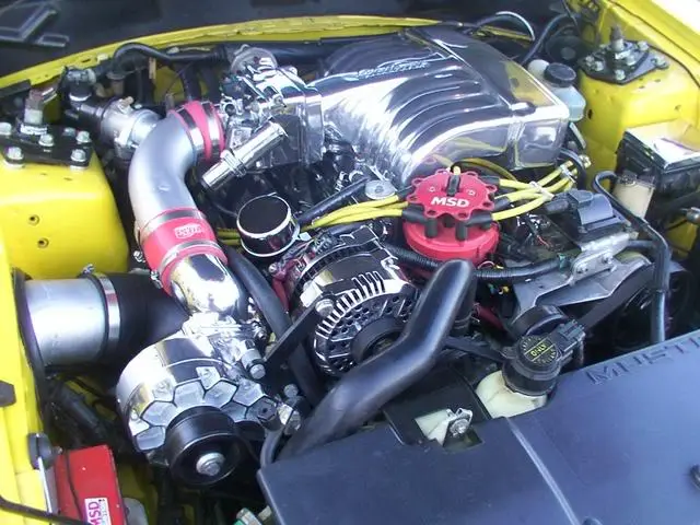

Do yourself a favor and just skip over the FMU thing, I tried it as well and got nowhere. I used a high pressure 255 pump and 42's on mine with an 80mm Pro M MAF and my car ran like a dream, but only after a tune! I ran a Vortech V1 S trim pushing 13 PSI and made 424 HP to the wheels with equal torque.
Here's a pic of my old setup:

Figured I'd post this dyno sheet up since people like to reference them, and to give a good plug for the tuner since they did a phenomenal job with my car!
