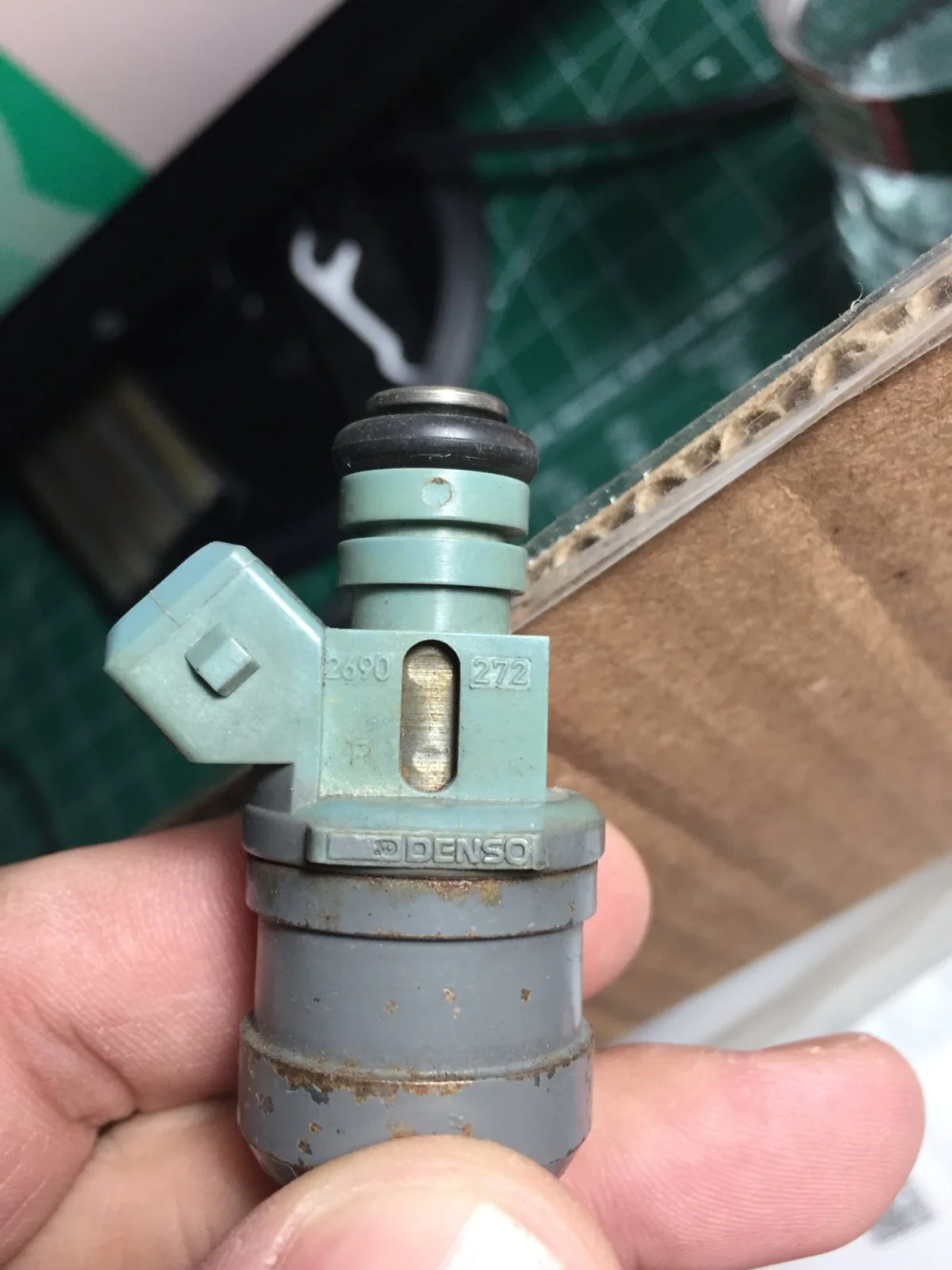

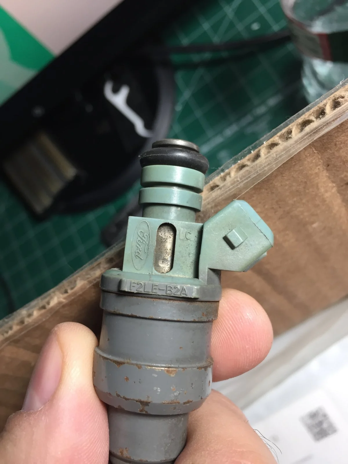

Anyone know what these are? Tried using google but could not really come up with anything? They were sold to me as 24lb injectors but I do not think they are. They are not blue, they are very light olive green.
Could be several; I found nothing in my listings with those numbers on them. Could be Toyota 13.5 lb/hr or they could be 18 lb/hr, or whatever. Honestly, you really have limited options. Without knowing what they are, you "could" send them off for flow testing/cleaning. Then you'll know. I just went through this and sent mine out for inspection; one came in nearly dead and the others were all over the place (also purchased on the used market). The cost to flow/clean/repair them was about $70 less than a new set of siemens-deka 80lb injectors, and they'd still be old/used injectors. So I just replaced them with a new set of siemens-deka 80 lb.
I have new injectors in my car, these are just a set I was going to try to get rid of but being they are unknown I will just toss them in my spare parts bin....to die a slow death I'm sure.
They look like the injectors off a Lincoln mark8, which are 24#.
I have a set, but I believe they are made by Bosch and have a Ford p/n on them.
They have the exact same color scheme though

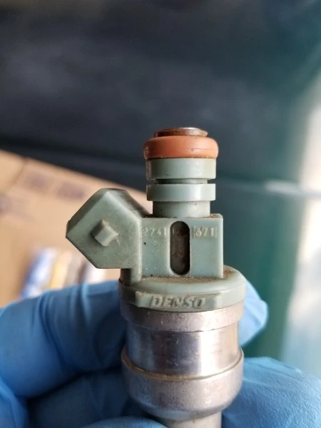

I know I'm late in posting this but figured a positive ID might be useful to someone. Your injectors are Denso #19550-2741 or Ford# F55E-A2E.
They are 24lb injectors and applicable to the Lincoln MK8 or Cobra 5.0. And yes, they should be light green for that number, light blue for the F2LE-B2A.
Found them on Injectorplanet.com if you want a pretty good general injector reference site. If you want specific applications though you have to dig elsewhere.
