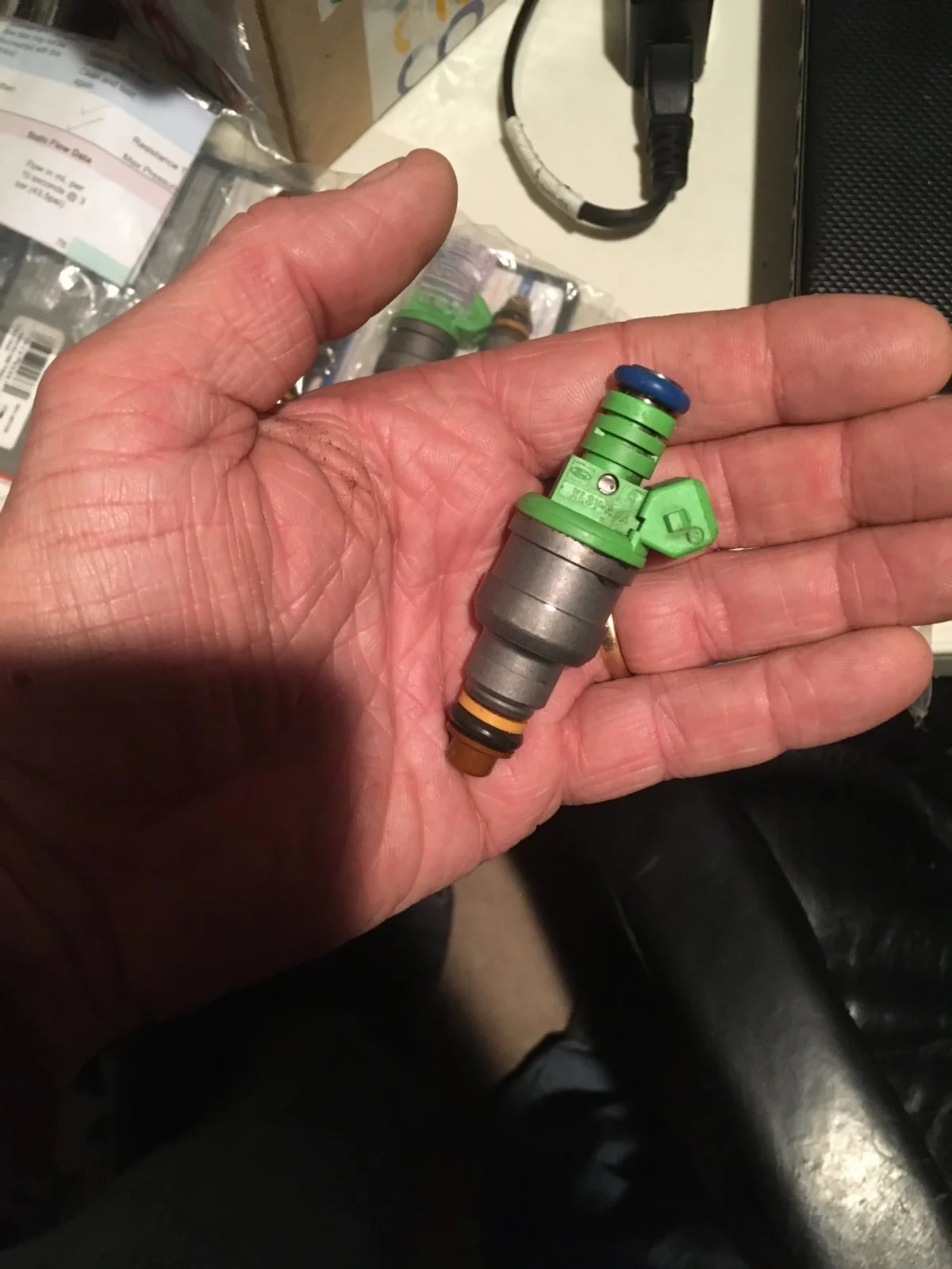

I have a set of 42lb OEM Lightning truck injectors I plan to eventually swap in place of the current 30lb's Im running right now. I had a Pro-M MAF and I plan to send it in to be re-calibrated for the 42's. Other than swapping the injectors in and re-calibrated MAF, is it plug and play with my existing setup? Will the tuned SCT chip continue to work in a similar manner to support things after the injector swap?
