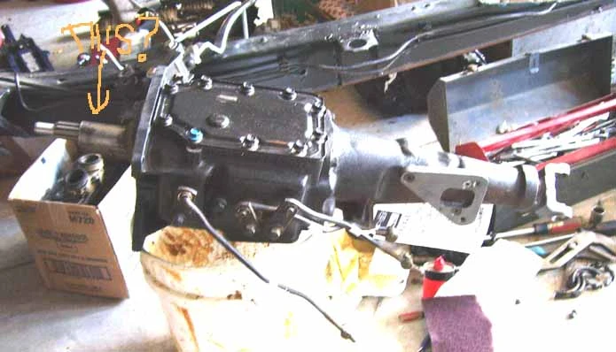

I think I found my problem. I have not noticed this retainer. Ill take pictures tomorrow, granted the trans doesnt drop on my head :nice:
I think you're talking about this thing here:
